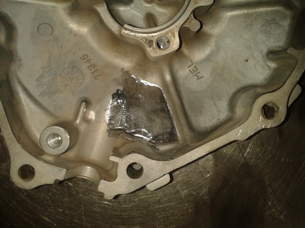

Ive welded quite a few Lambretta engine cases with 4043 , sometimes it works well sometimes it looks terrible , if they are oily its bad news ! not tried Mag though
I once tried welding a Mag case with 4043 and thats the first pic ! The second two are after using Mag rod.
As HR has said there expensive but I am sure someone on here would sell you a rod or two.
I recently did a kwack cases with 4047(12%si). I ran out of 4043 and needed it done. I was not 100% confident it was suitable but some wise and informative words from Hotrodder helped out loads and the consumable worked really well (as well as you'd expect from a bike case alloyed with everything unfriendly mind).
