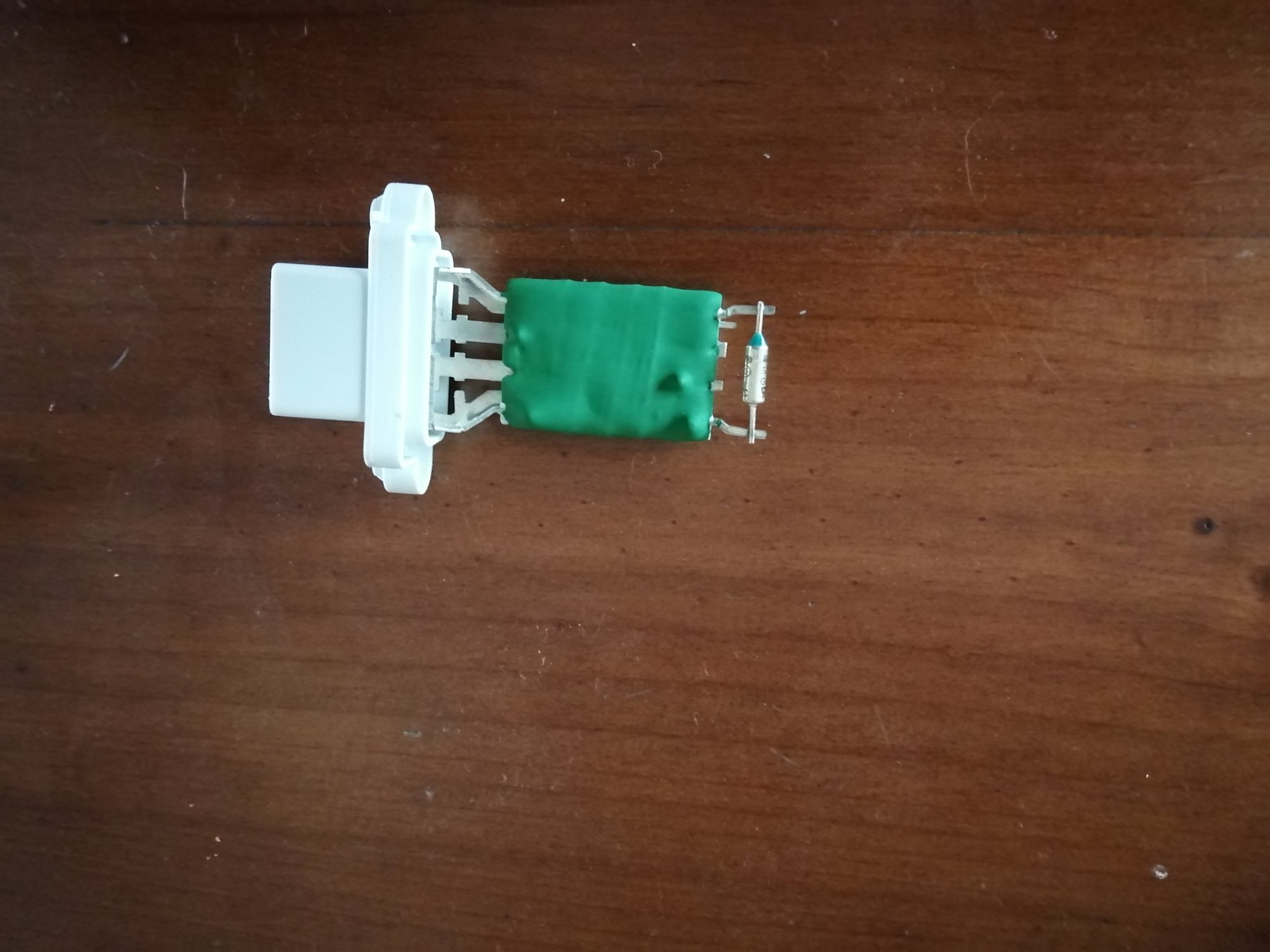

2010 fiesta, heat only comes through when the dial is clicked to five and I can actually hear the fan.
Any clues?
Cheers.
Any clues?
Cheers.

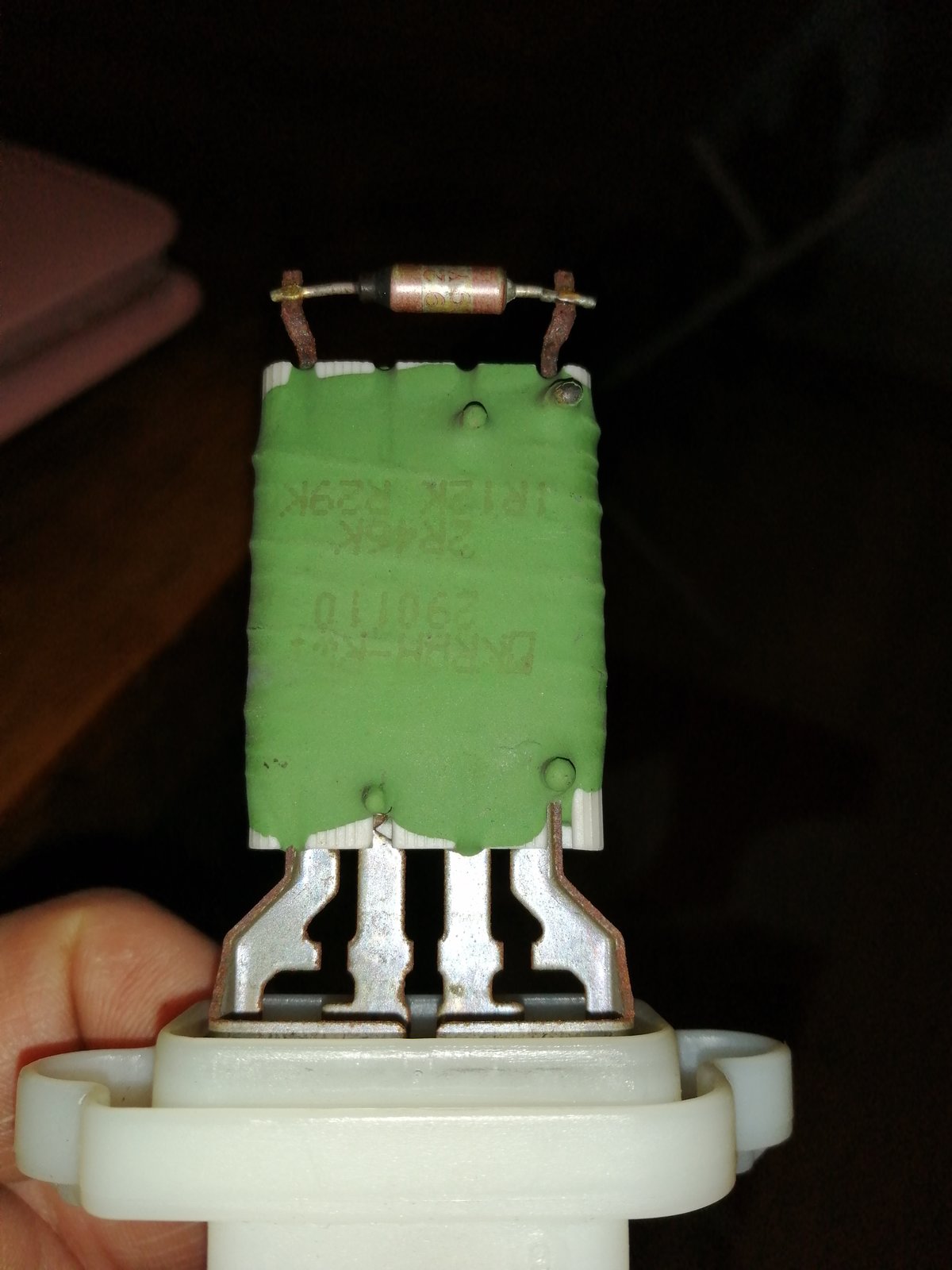

Dead hedgehog.so the fan dont run till no5 ?, that be the rheostat burnt out, usually found in the heater trunking or casing![]()
Just YouTubed it. Dead easy, unscrew a bit of facia in the passenger footwell side.
Resistor is there.
Happy days.
Yep, you notice it this weatheryep that’s the issue
atleast it still works though even when the resistor is out
Although reading reviews they only seem to last about 3 years, so resistance is useless.
