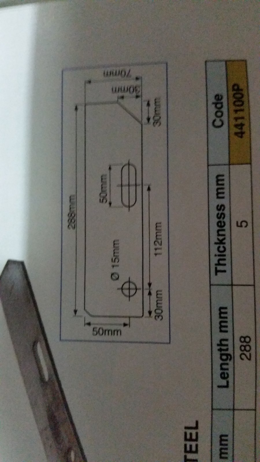

Revs1972 Member Messages 1,797 Location Torquay, UK Jul 30, 2019 #1 Ordered some stair treads from Brundles earlier. Just in the process of drawing them into my stairs model and realised I do not know where the holes are in the end plates. Does anyone have a drawing, or know the hole patterns please? Cheers
Wonderweaver Member Messages 269 Location Manchester Jul 30, 2019 #3 Yeah there loads and should have holes diagrams on the site.
Revs1972 Member Messages 1,797 Location Torquay, UK Jul 30, 2019 #4 Oh yes, would help if I said which ones https://www.fhbrundle.co.uk/product...irtread_41_100_1000_x_288mm_25x5mm_Galvanised
Revs1972 Member Messages 1,797 Location Torquay, UK Jul 30, 2019 #6 They look very familiar.... thank you for your help.
