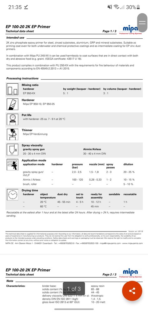

I have Mipa EP 100-20 2K EP Primer it says on the spec sheet and it says recoatable after minimum 1 hour it also says it needs 2-3 spray passes does that mean that I need to wait an hour between each pass? Or is that talking more about putting a top coat on it?
If I can do the 2-3 spray passes with less than an hour between coats how long should I leave?
And last but not least on this topic is dilution thinners?

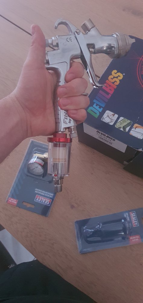

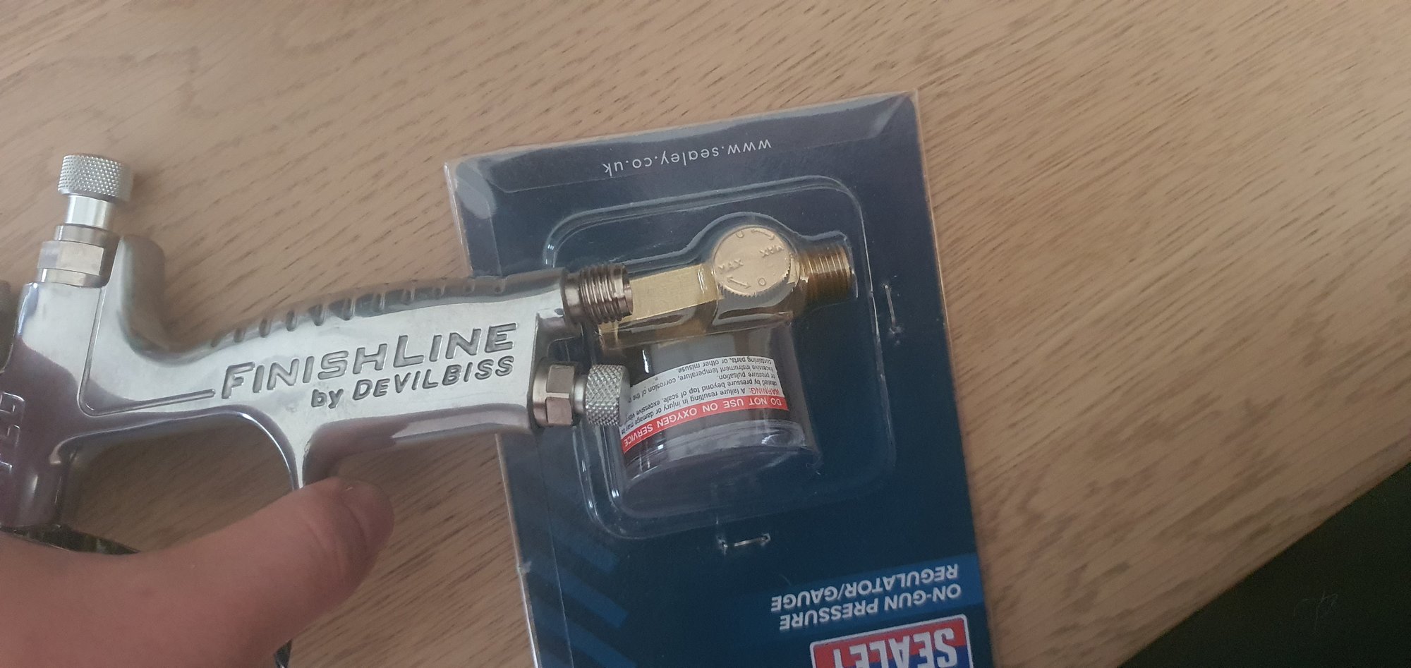

My next question is after I've bought my first spray gun, regulator and in line water filterbut the regulator won't fit onto the gun as the air control valve prevents it screwing on.
I could screw on the water trap and the. Out the regulator on if that works but that air control valve needs to be screwed in funny so not sure if that's a problem or not.
