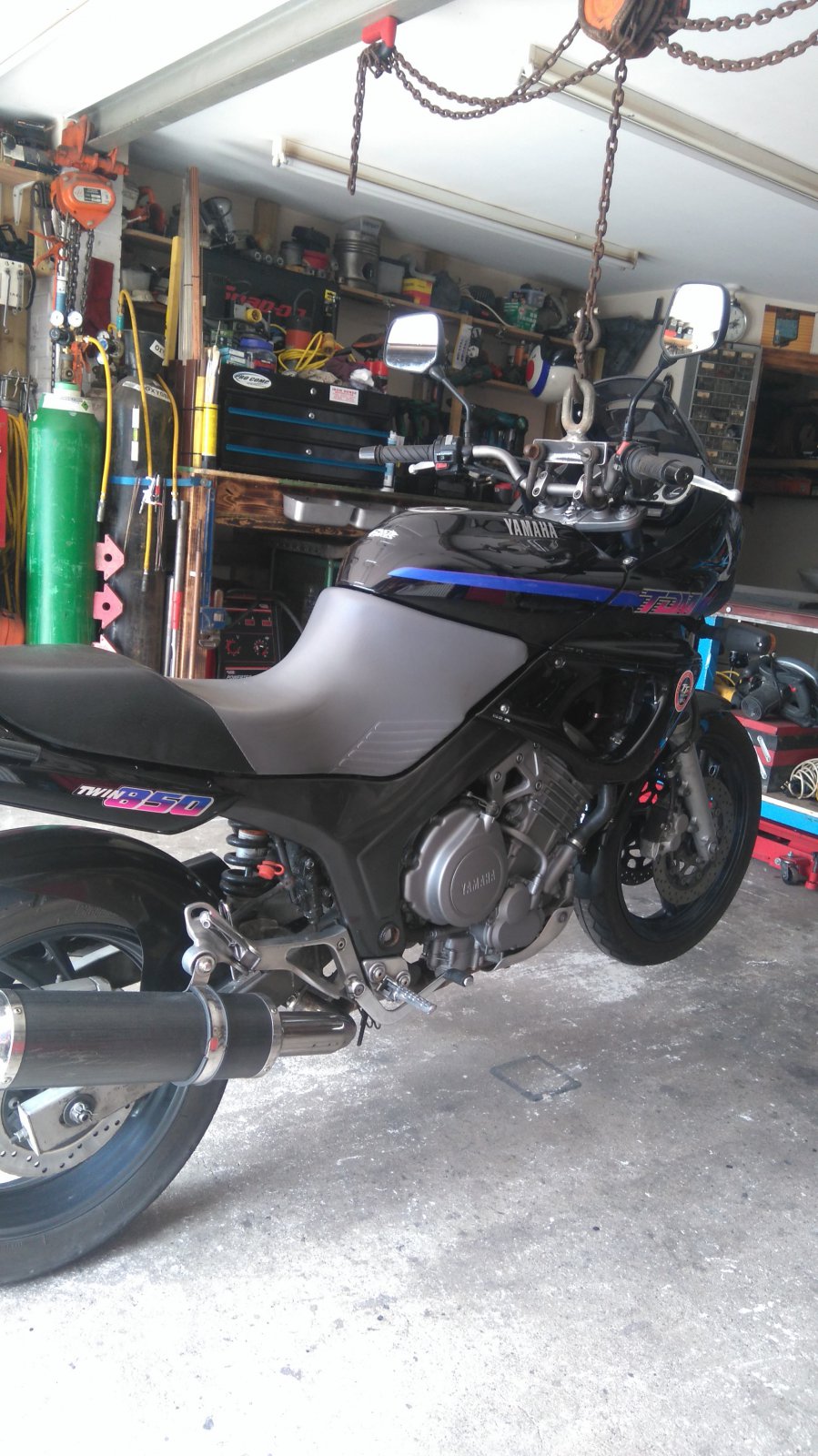

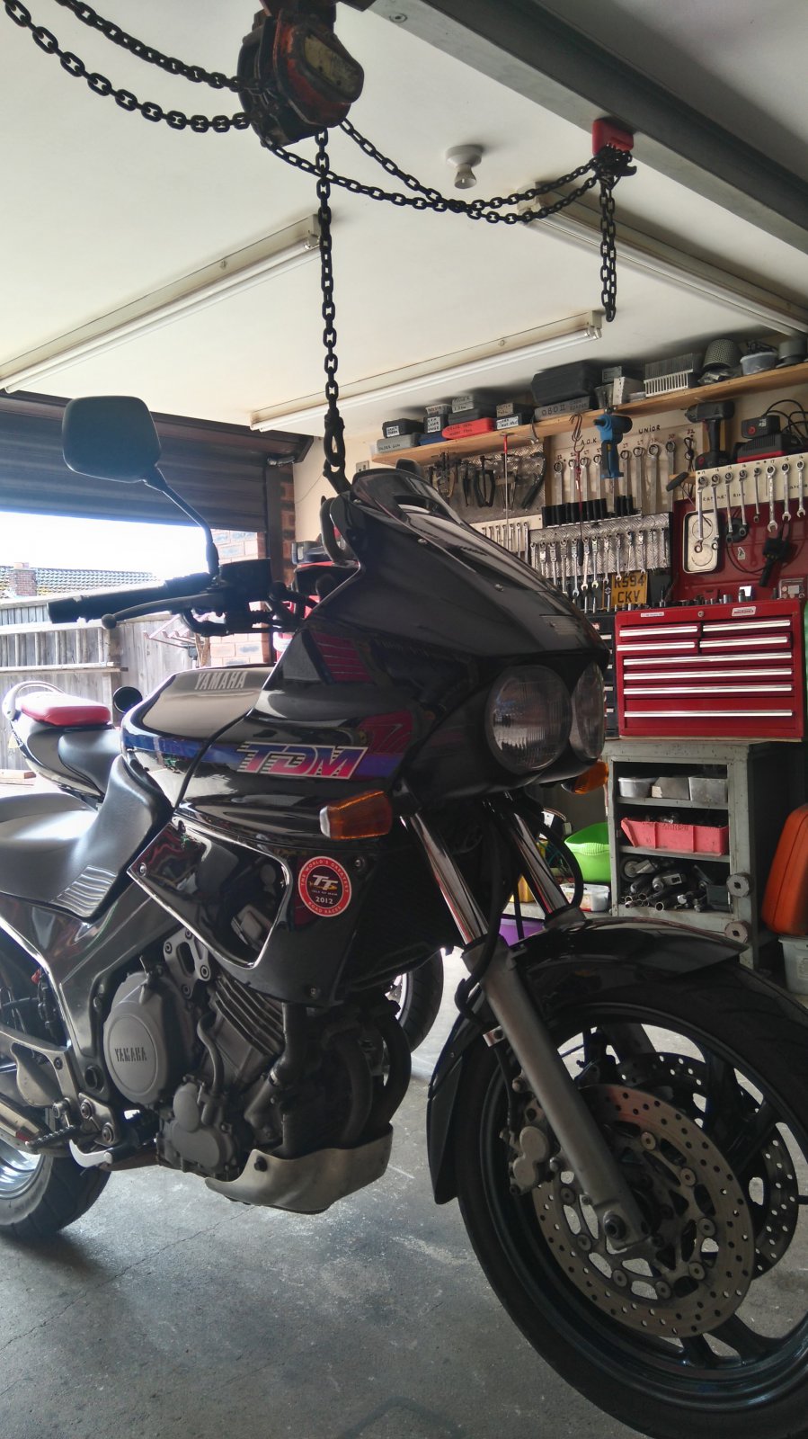

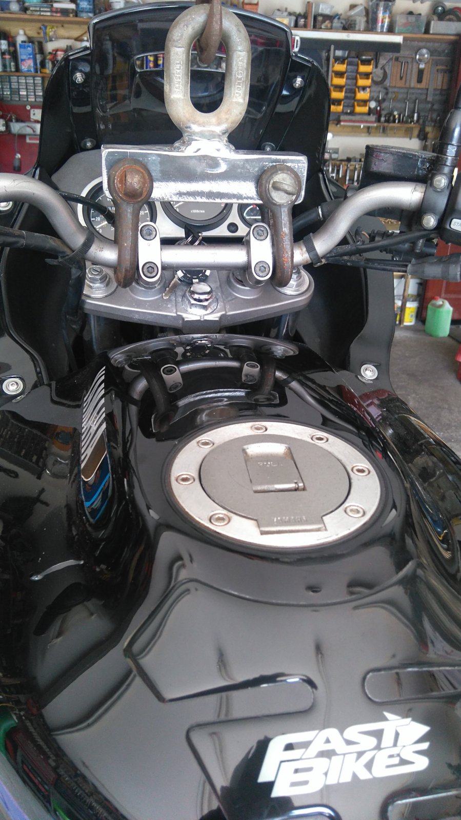

Couple of new seals and a flush out including new oil on my fork legs today promted me to make this bracket to hang the bike as i hate using jacks on bikes...straps are fine but this keeps the bars straight and worked well...only problem being it worked so well its now still hanging with no legs and its carbs on the bench for a strip and clean too,its been a bit "fluffy" low down just on the transition from pilot to mains..fine when on the mains
