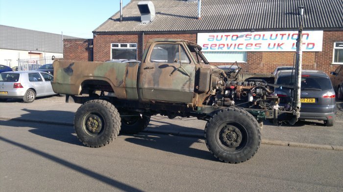

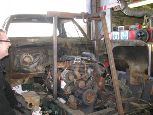

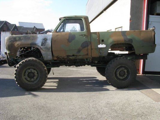

been rolling in n outta here for a while-thought i,d best gross ye all out with my stupid truck build-got the idea about 7-8 years ago-gathered a few parts and then decided i wanted my back garden back-so i used a combo of stihl petrol cutter-milwaukee sawzall and the brotherhood of grinders [all makes going back 25 years] and my kemppi TIG n BOC mig n ARC

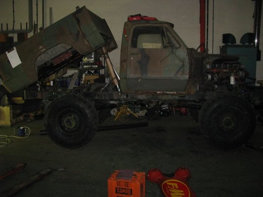

chassis donor=1959 SUMB-like a unimog but FUGLY-i mean butt fugly!!
bodywork,cab and rear tub=1977 M880 [mil;itary version of the dodge W200-came free with rust,trees and all sorts of critters=rotten beyond sense

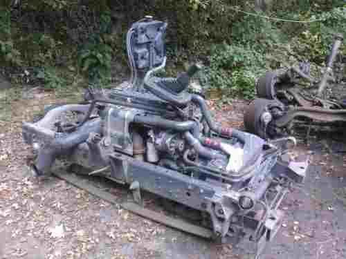

engine=5.9 LITRE CUMMINS 6BTA turbo aftercooled=grummaged out of a DAF-1997
this is pretty much how it sits now like-took me over a year on n off to do all the work and find/afford all the bits-still a rake to do so-
