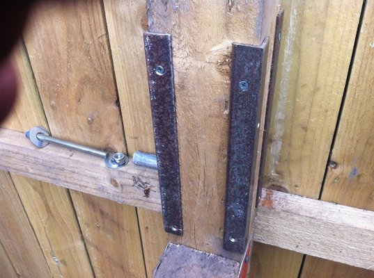

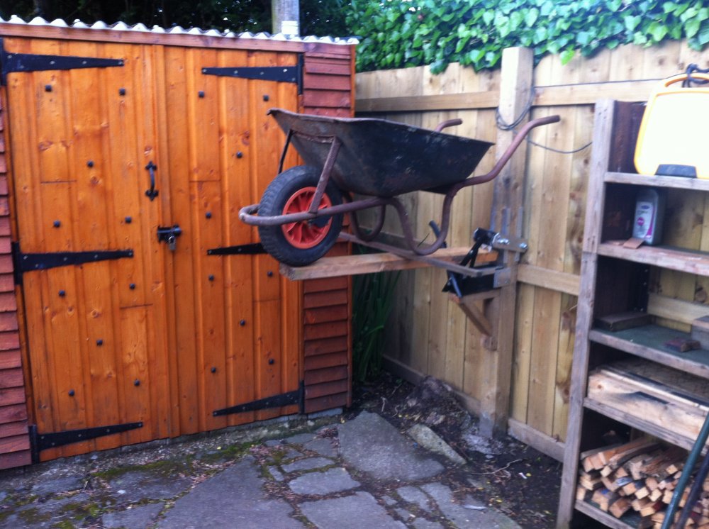

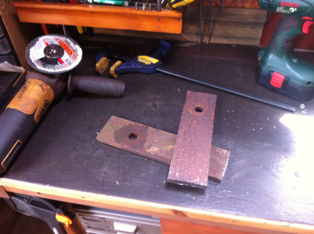

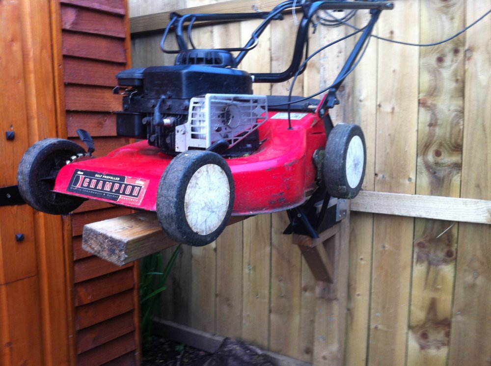

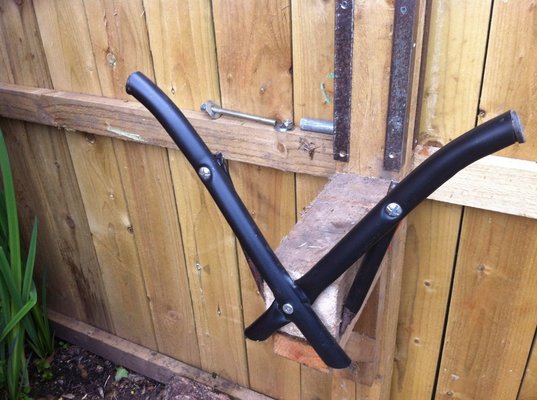

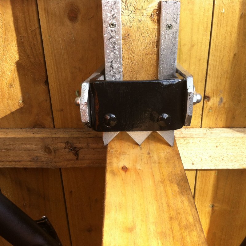

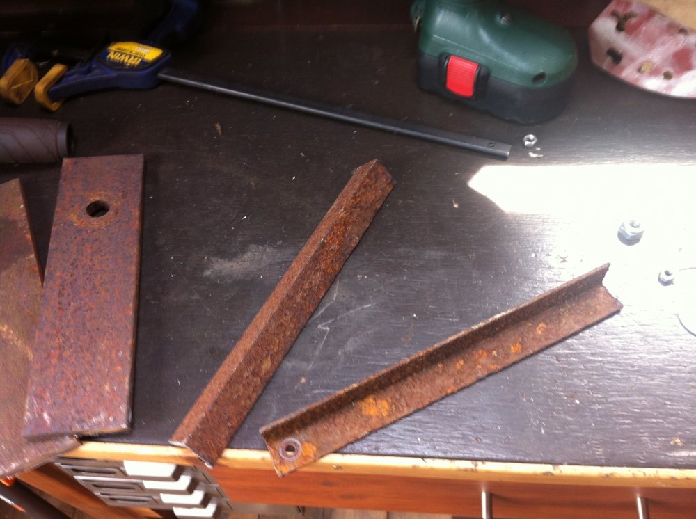

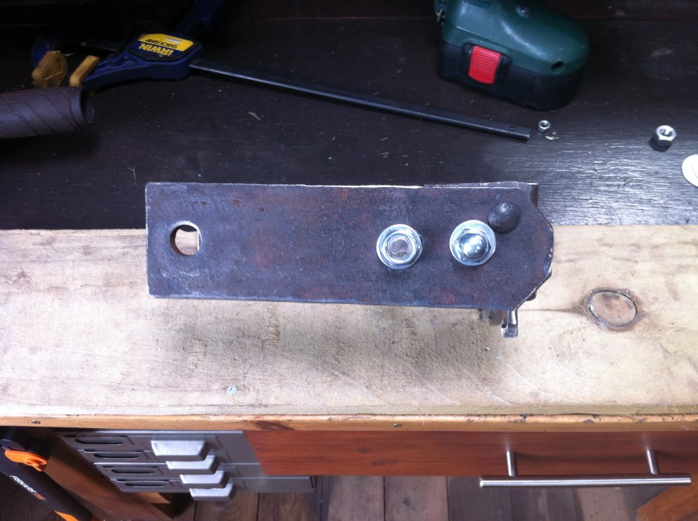

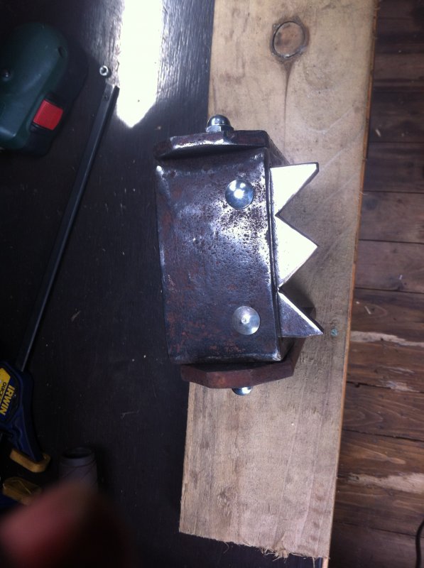

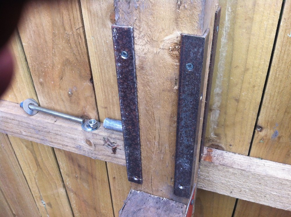

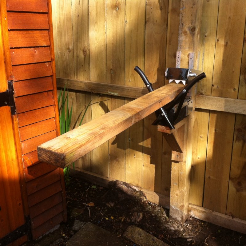

fence posts are quite strong(when in decent nick!) so having sunk some new ones in concrete i thought why not mount a log holder to it...using old gate hinge,angle iron,threaded rod,off cuts of tube etc.. anyway this was the result..didn,t take too long..self adjusting and gives me some where to park the wheelbarrow/lawnmower!
