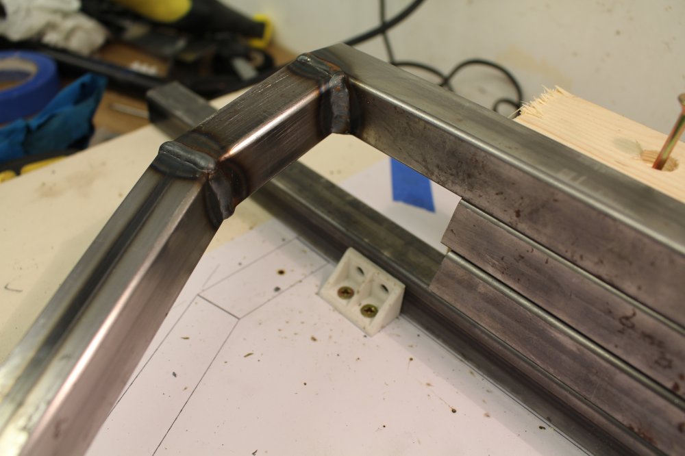

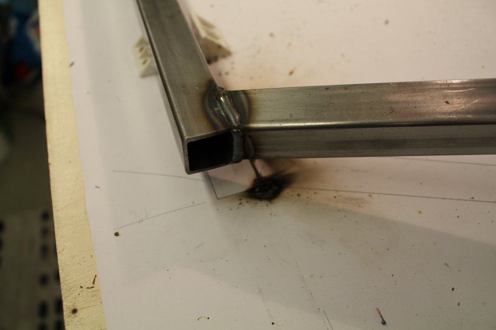

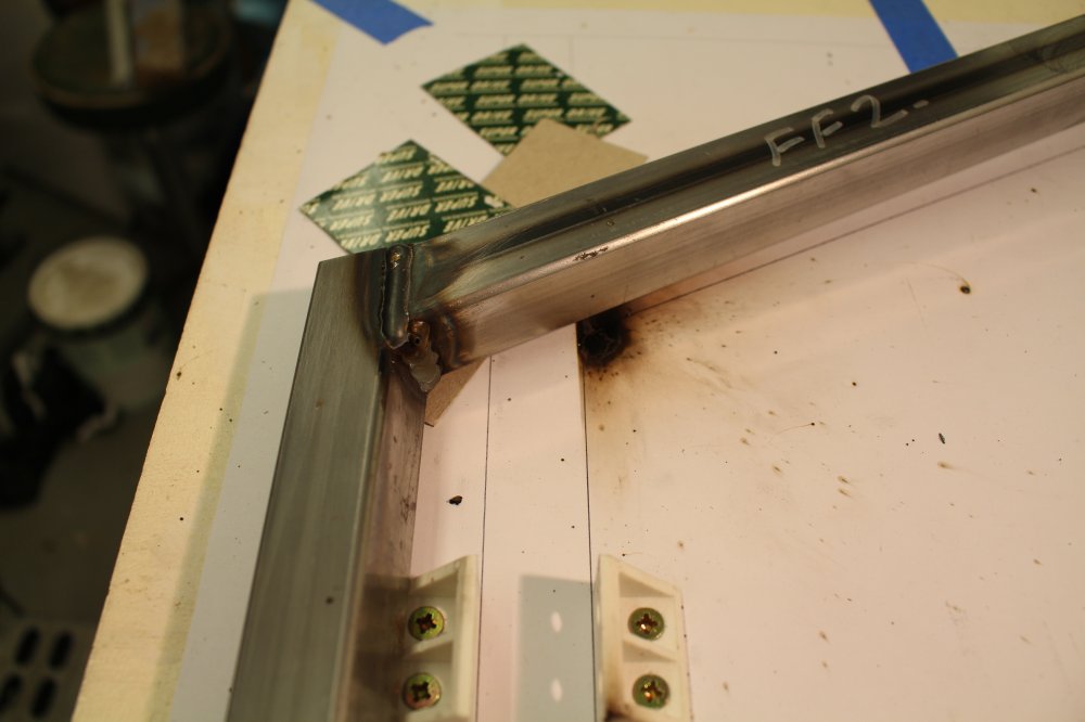

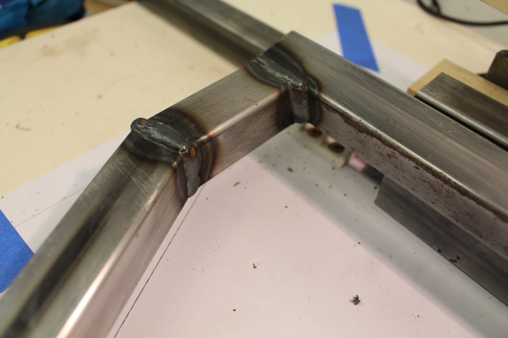

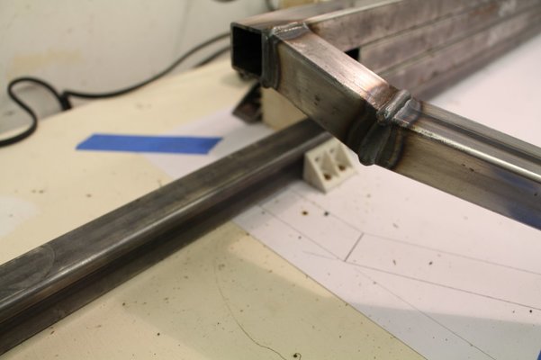

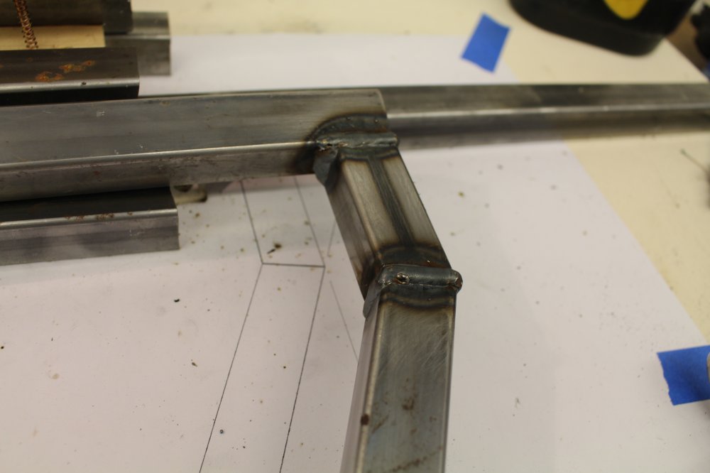

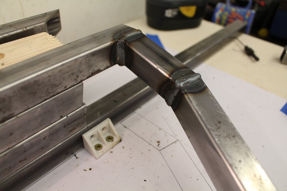

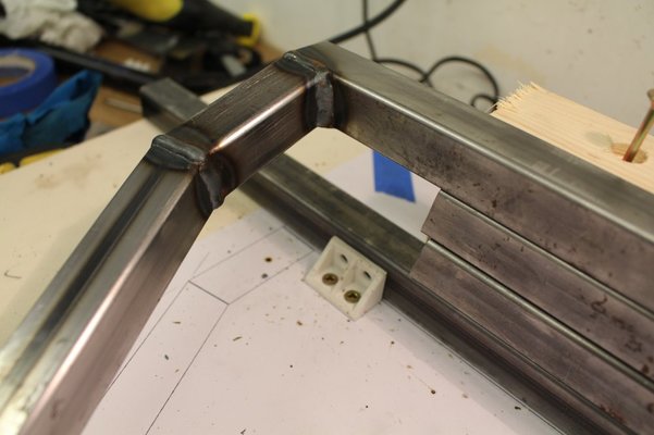

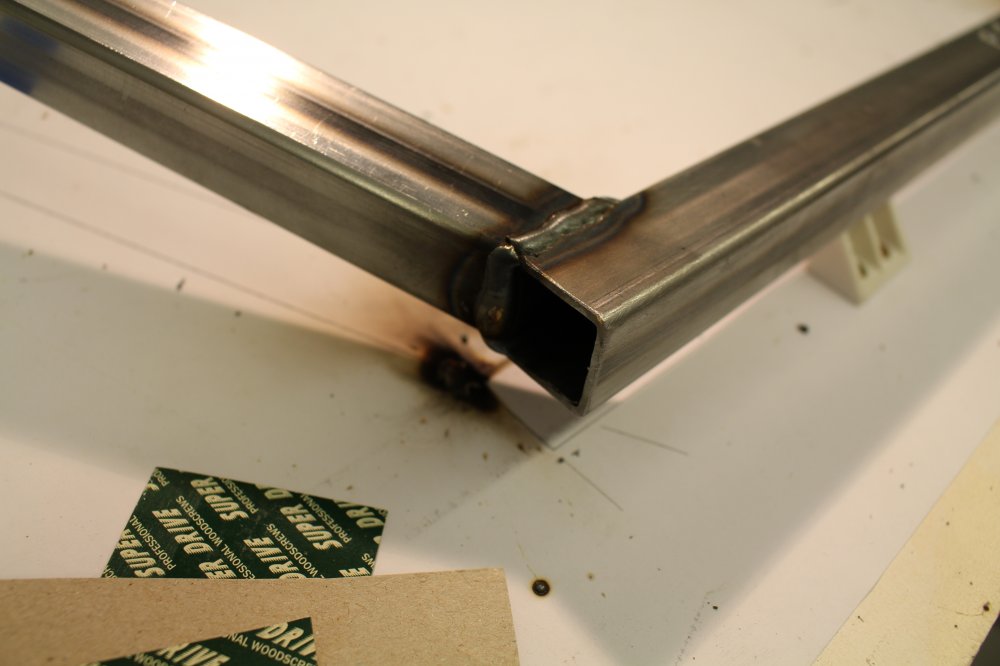

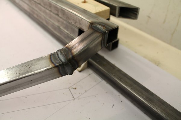

Perhaps I'm completely wrong, but did you leave a small gap between the pieces being welded? Without space for the weld puddle to 'sink in' between the pieces it has no option but to stay on top.
not always, if you have a high enough powered machine it will sink in, but for a hobby machine it is recommended as they usually don't have the powere required for a full penetration weld over a certain thickness. we have a 400 amp mig in work that will blow holes in 15mm steel so we never leave a gap for anything unless its on the drawing
tyro? what that then?
Beginner/trainee/learner.
with that welder you wont need a gap on that thickness. as said above really just a bit more travel speed should flatten the welds out, but if your going to grind them back afterwards I wouldn't worry too much as long as they are strong

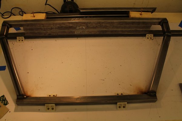

Thanks, its Haynes flavoured, although its +100mm width and with a couple of other rail alterations. You building as well?
