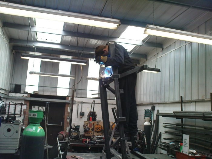

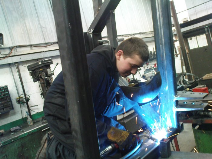

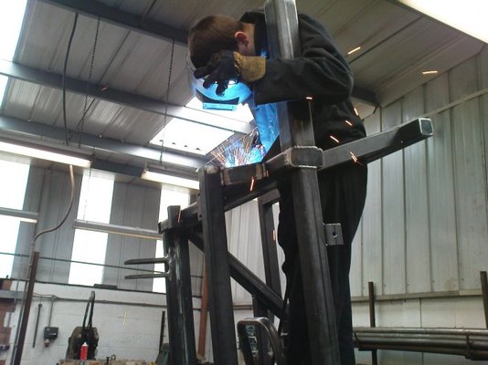

this is the chassis for a granualer fertilizer used for potato planting that i have to weld many off this time of year
my favourite part is the 60x60x6 box section on the bottom because 8 out of 12 of the welds have to be triple welded and the other 4 need allot of penetration the weld is about 300mm long and it takes on average 5.30 miniutes to do that weld because the gap your filling up is huge. i love welding getting paid is just a bonus
