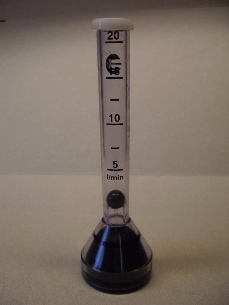

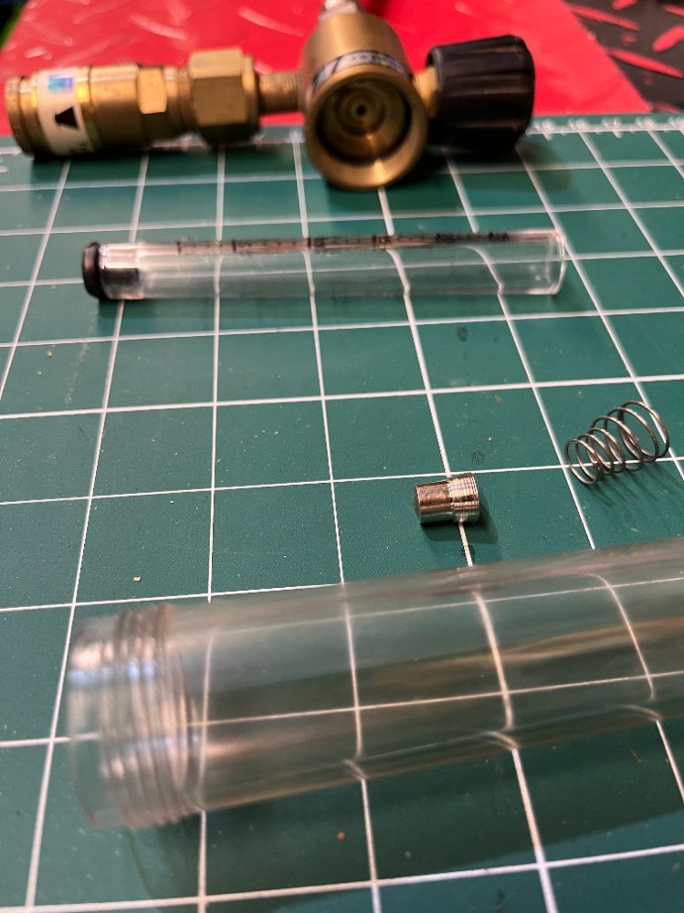

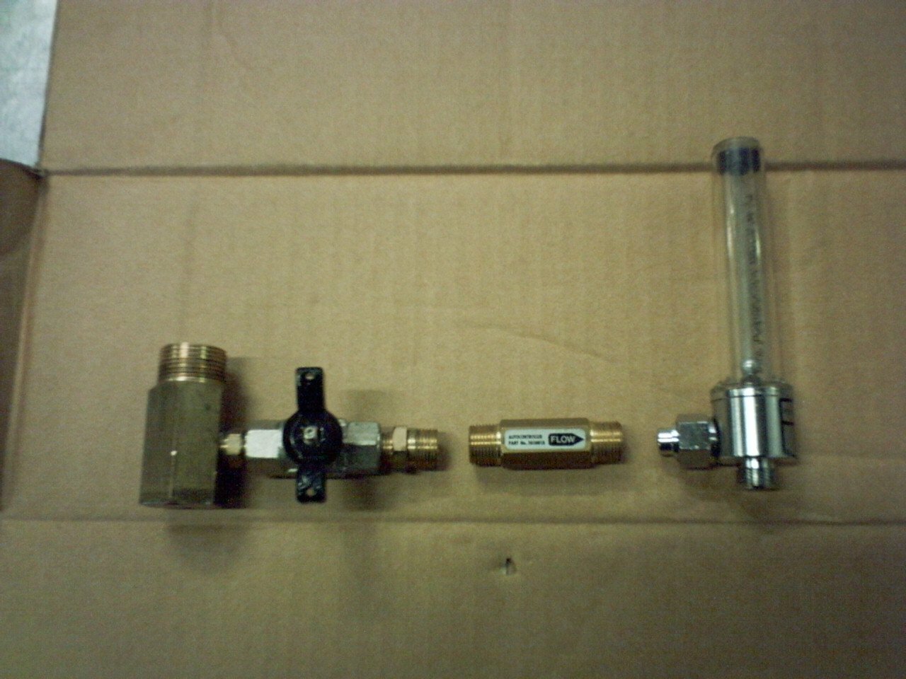

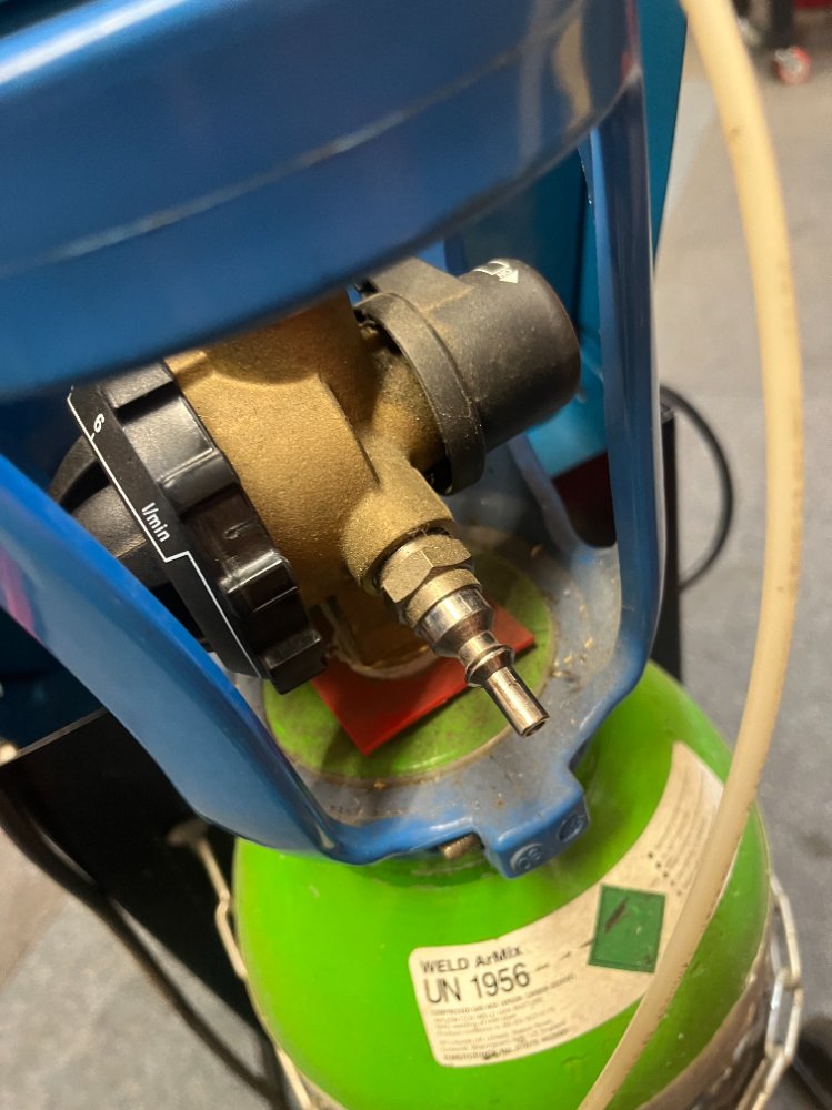

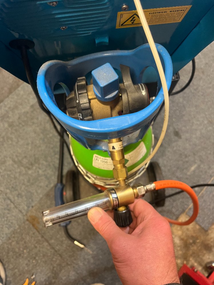

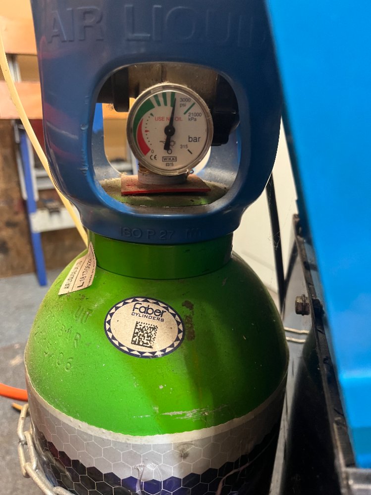

Doing a bit of mig next week so thought I would check the gas, bottle is reading about 200 bar.
Peashooter is reading 5LMP max on full adjustment of bottle and shooter, but a healthy hiss from the torch.
The shooter 5LPM indicated seems stable, not dropping but will not go higher.
If I disconnect the hose & peashooter and open up with the LPM on the bottle, again a healthy hiss and increases if I adjust the bottle LPM.
Can't detect any leaks.
Could the peashooter be faulty?, or getting low pressure 200ish bar not being enough?
