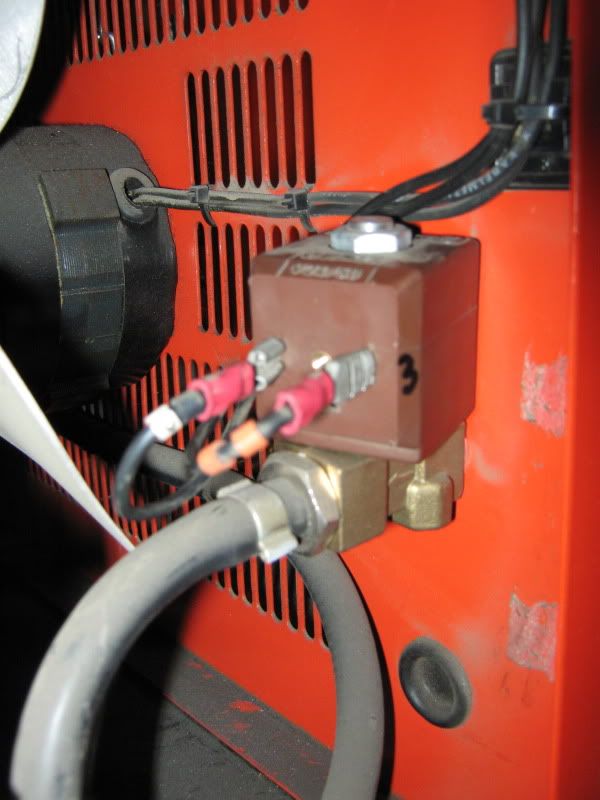

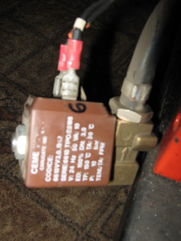

the gas valve in my tig does not work.it has never worked the whole time i have had the welder when i got it i did not think it had a valve inside it but someone on here pointed out that a Hf start tig usually have valves so i opened it up to investigate.
the valve has 3 male spade connectors on it but only 2 are connected and there are no loose wires etc.. or obvious faults that i can see
is there a way i can test the valve? i put a meter across it and had continuity on the two pins that were connected.
