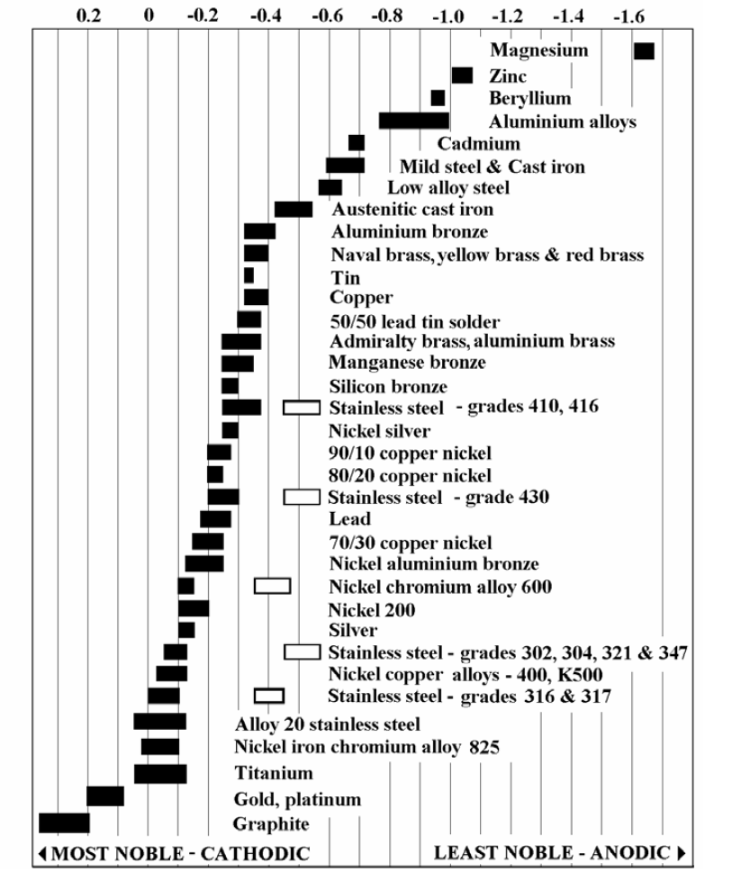

Hi,
I have an application where I need to fasten aluminium together via hex head bolts. Can someone please advise if stainless would be OK .
Apart from stainless, is there any similar corrosion protected fastener which would come close to gals?
