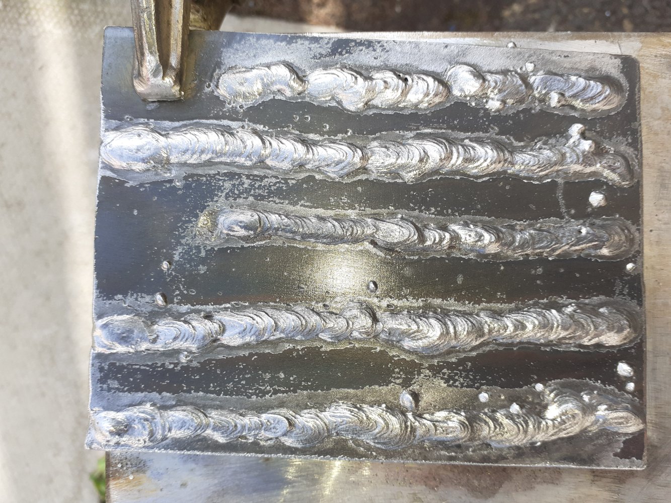

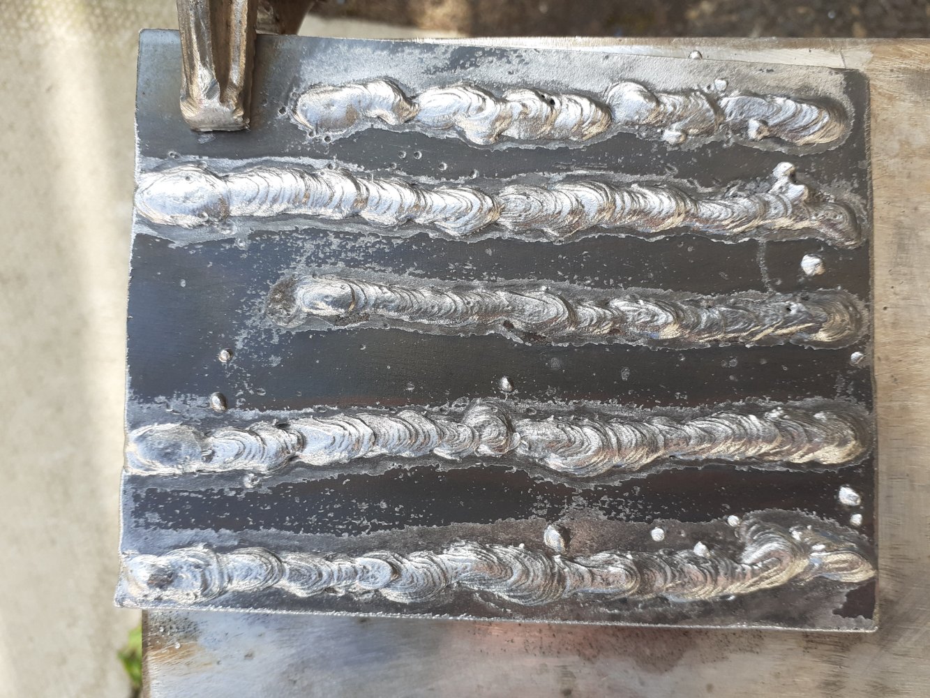

I cut off a short length of 5mm thick mild steel, to practice some beads on. Do you call this a 'coupon', even in the UK?
Using DCEP @ 90 Amps with 2.5mm E7018 rods, I tried for a few straight beads. I never bothered to remove the mill scale, on this attempt.
I used both hands to hold the rod, but I was getting a fair bit of heat through the glove, causing me to be a bit jerky with the rod. Wire brush and Dettol certainly helped with removing the slag.
With and without flash photos.
Thoughts?
