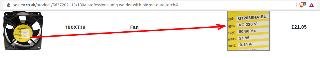

hi .ive got a sealey 180 supermig.its welding ok but the fan's stopped. has it got an external fuse ?whats the best way to test the fan
Yes it rotates freely. I heard a pop then the fan stopped. That's why i thought it was a fuseHello, and welcome to the Forum.

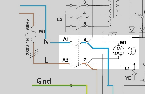

According to the circuit diagram in post #5 of this thread:
https://www.mig-welding.co.uk/forum...permig-euro-torch-gas-solenoid-problem.99746/
the fan runs on AC mains, so yes, you could try putting 230v AC across it. Check the data label ( if any ) on the fan first, to confirm the voltage.
Have you tried helping the fan to start by giving it a spin? Does it rotate freely?
