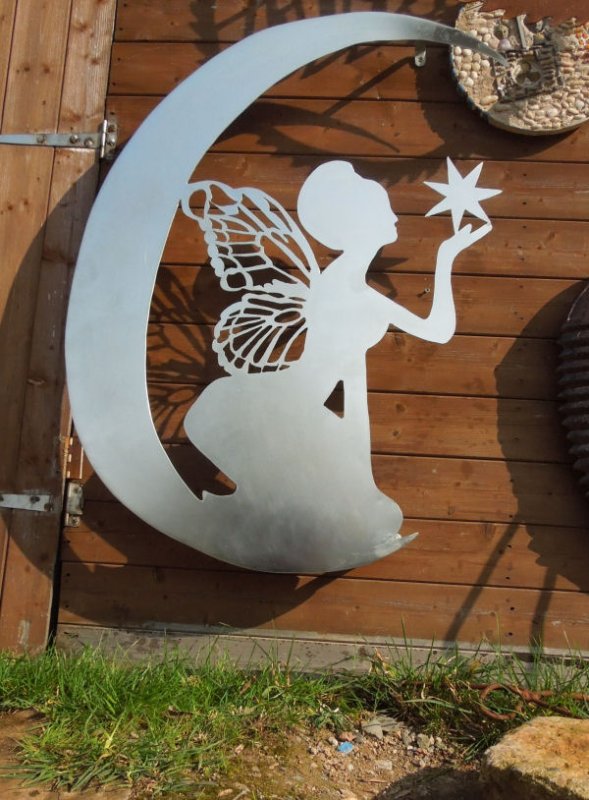

I was asked to make a sculpture of a fairy to go on the wall at an old people's home as part of a sensory garden. About 1.2m top to bottom.
I used to design this kind of thing so was happy to get involved, we looked at some simple art work ad a design was selected.
I scaled it up with an old OHP (great things) and cut it out with the plasma cutter then took it off to get it zinc plated.
Yesterday mid paragliding session (between flights) I answered my phone. 'She aint lookin' too good but shes done'. Panicky thoughts ensued.
Went to scope out the damage today, she did not look too good, streaky and blotchy, not good. I was asked to pay a nominal fee and was happy to do that. I did try a blob of spit and quick rub and the result was promising.
Took her back to base and 'By The Power of WD40' she was reborn.
A massive relief, she came out lovely.
