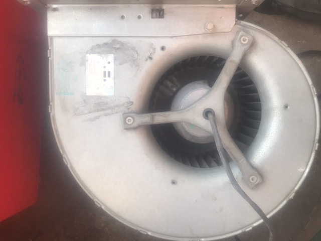

Filter manufacturers will tell you the pressure required for a given air flow rate. Damp dust can quickly clog a filter. Modern filters will usually have a self-cleaning facility, very old systems may have nothing more than some hanging filter socks that have to be emptied manually (not a particularly pleasant task).

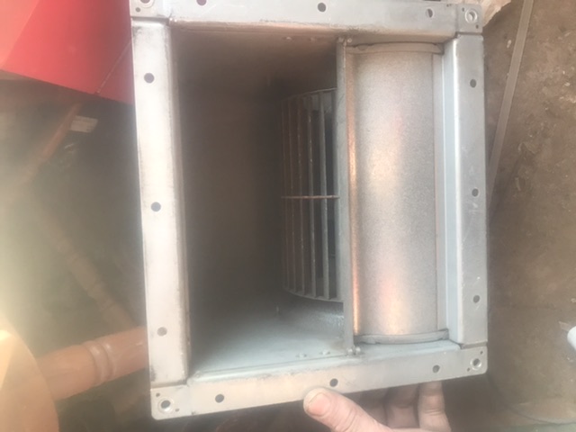

The fan in your photo has a large number of forward-curved blades, on which dust can build up. One with backward-inclined blades would be better for handling dust, and also able to generate much higher pressures (see comment from Parm, post #14). Paddle blade fans are even better at handling a lot of dust, but less efficient (take a lot of power for any given air flow rate).
