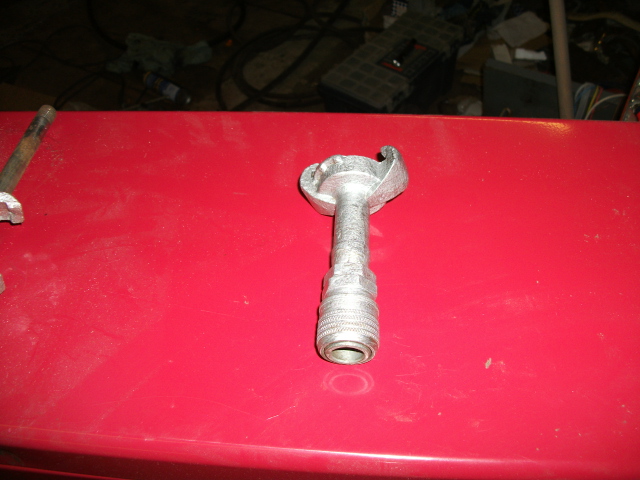

hi all, im new to this site, ive got a bambi compressor, its not very big but its dead silent so i dont really want to get rid of it as can use it late at night, its only 50 litres per min and the tank is abit small, (about 25 litre) i only need a tiny bit more air so i was going to add another tank, so when they are charged up then will do just what i need, i only want another 25 litre just to give me more trhan enough,
has anyone ever done this and how?

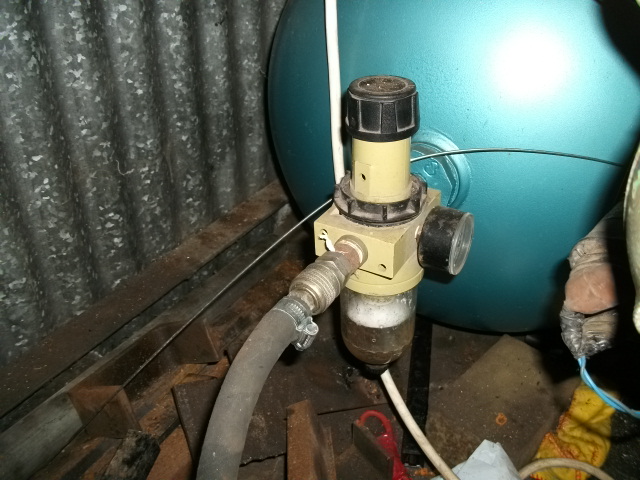

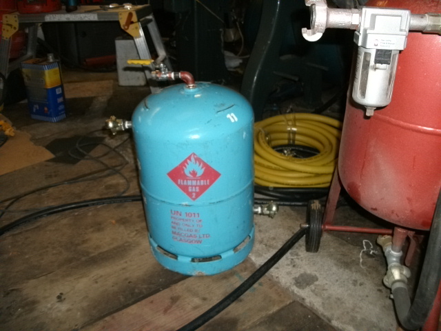

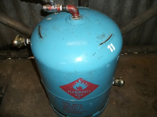

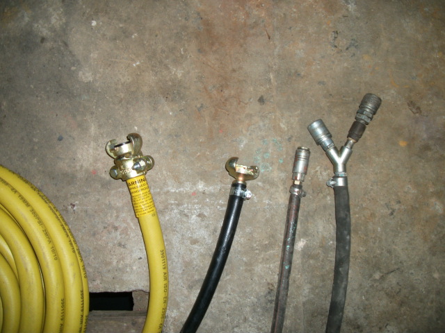

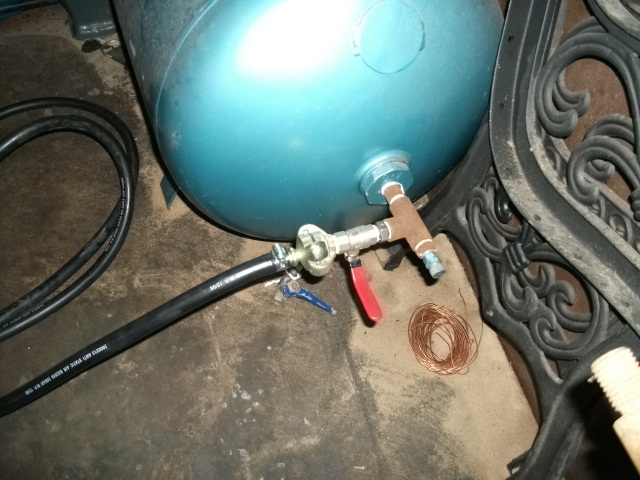

cheap and chearfull. for extra storage just use a tee piece with a ball valve in the airline in to a spare tank .heres a few pictures
you might need to drain that water trap brightspark
