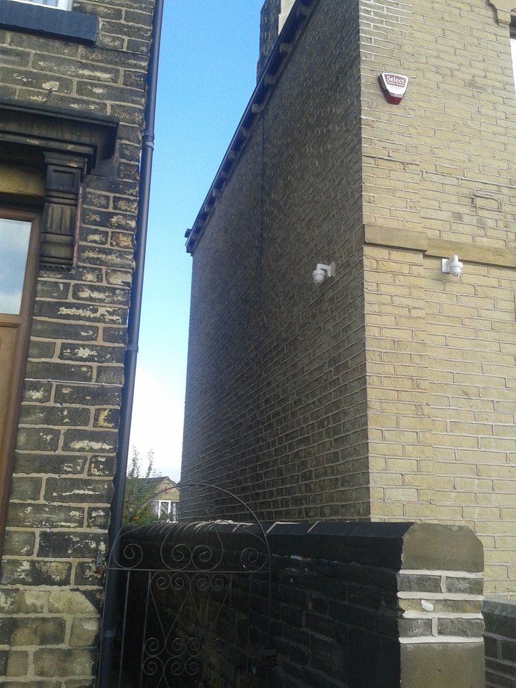

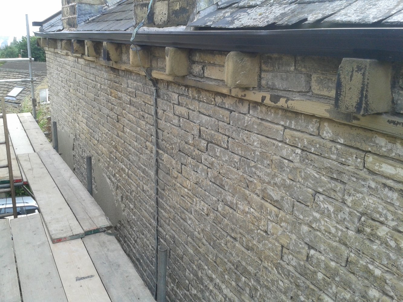

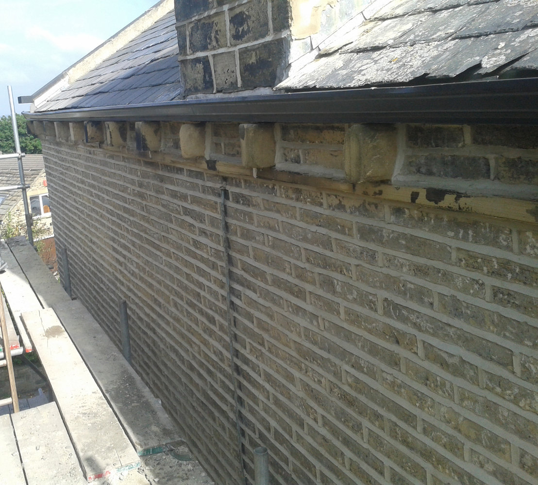

I have an old house to renovate.
The pine end needs hacking off and re rendering.
It is a cavity wall but it is very exposed. High winds and driving rain so cavity wall insulation not recommended.
Is there some external stuff I could use that does both jobs?
Finish needs to be white quartz type pebbledash.
