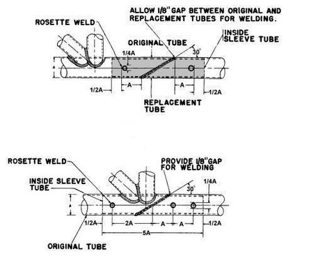

hi folks , ive spent many a long hour reading some of the excellent info on the forum but now i need to ask a quick question
i'm currently starting out on building a bobber hardtail motorcycle but i need to extend the rear swinging arm by around 4" ,( adding the 4" half way down the swing arm ) the swinging arm is around 30mm round steel bar but i'm wondering if i need to weld in an internal sleeve to cover both welds as i don't really fancy just butt welding
any advice would be greatly received
