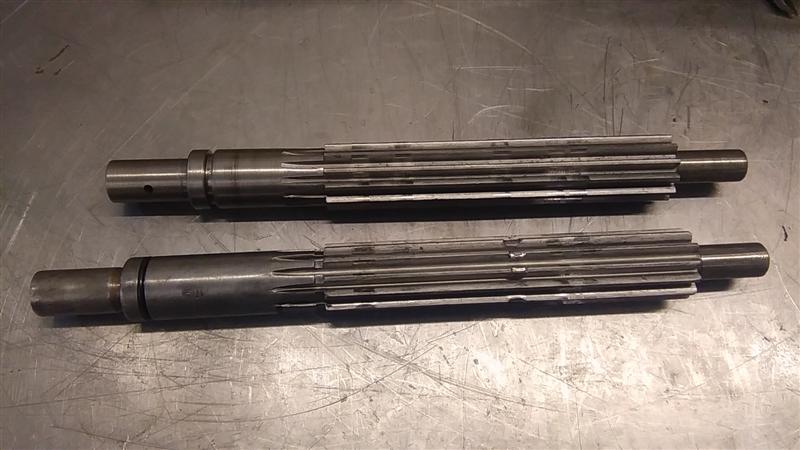

I got a new gearbox, but for a slightly older model. Everything fits except the spline gear which is too short on one end, it has a different outboard cluster arrangement. Here's how I fixed it.
First I decided where the join was going to be and parted off the wrecked shaft.

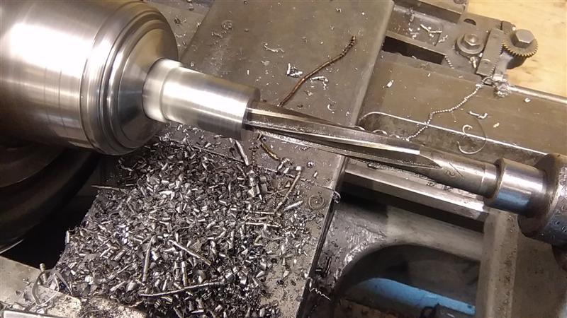

I parted off the replacement shaft, then drilled it and reamed it to 1/2" bore.

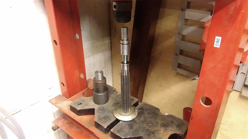

After that I machined the stub end to 0.5015" to give a thou and a half interference. Coated that in high strength threadlock and cut a small sliding-fit on the end to make sure it started properly. I drilled a 2.5mm hole in the bottom of one of the splines into the bore, to let out any air or trapped threadlock. Set it up in the press.

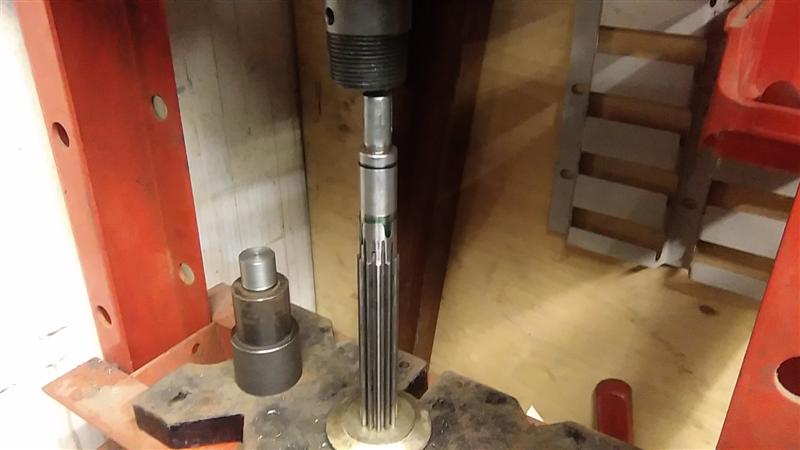

Pressed the stub home up to the shoulder. It took 3.5tons which I was pleased with. If it had been much less I would have considered pinning through the cross hole.

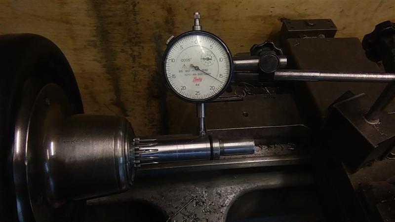

And that's it. Set up in the lathe and I got 1 thou of runout. Not worried about that because the shaft is already a 0.002" undersized from normal use, it's 30 yrs old and the shaft runs straight on a cast iron bearing. I cleaned it up with a bit of emery and assembled the shaft into the gearbox.
