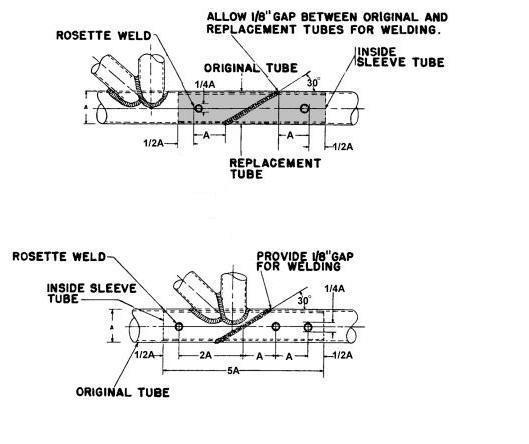

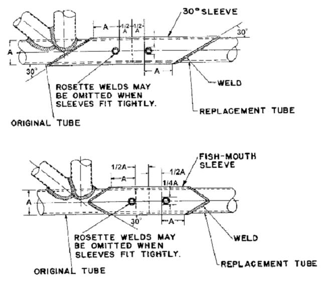

I've got a Marlin Roadster based on a Marina. It's a SWB model but they also made a LWB which had an extra 6" in the cockpit area. The chassis is a simple box section affair (I think it's 4" x 2") and extra area is in a straight / parallel section. People cut the chassis in half and add the extra to existing cars so I'm considering doing the same to create better legroom.
So what is the proper way of adding such an extra section into a chassis ? I assume not a simple cut and weld in. Is a stepped cut the way to go ? If so does the step go in the top and bottom or sides ? Is it necessary to add any inner reinforcement ?
Thanks.
