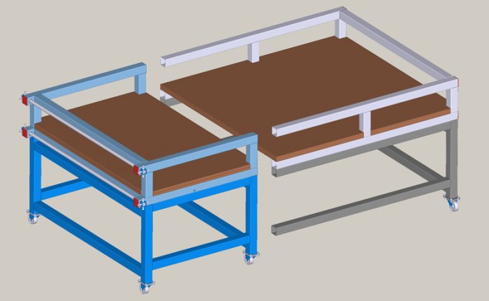

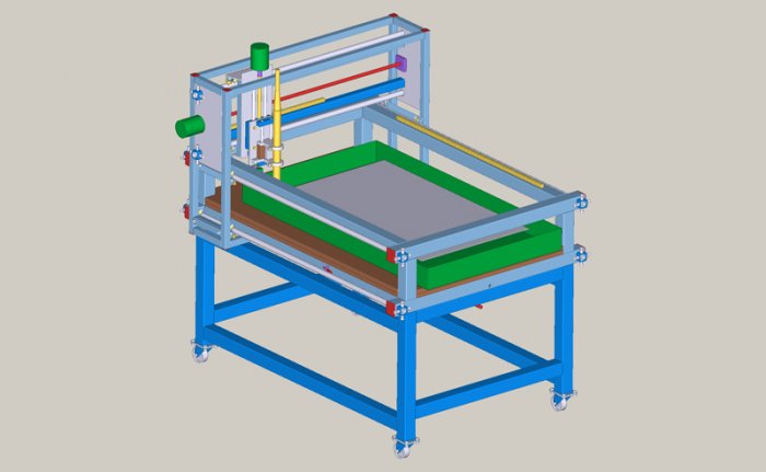

I have a Homebuilt CNC Plasma machine and I am toying with the idea of extending the table size by doing a 'Cut and Shut'
This is what the machine currently looks like.....
http://www.youtube.com/watch?v=Cn1Sgeo6jas
The current working table size is 1000mm x 600mm and I would like to extend it to take a standard 2000mm x 1000mm sheet
The frame is made from 60mm Box Section with a 1.5mm wall
I have attached the original design and the proposed stretched version.

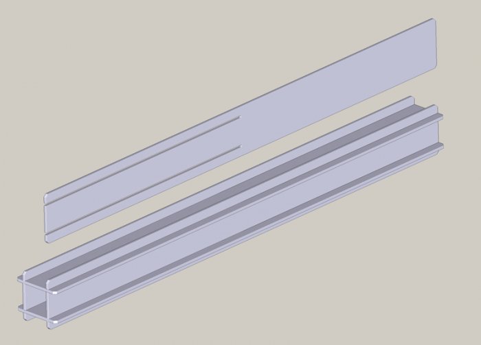

Question, does anyone know a quick and easy method of joining the tubes together end to end?
I need some form of inner tube to fit inside to align the tubes.
The internal square dimension is 57mm so perhaps a section of 2 1/4 square tube (57.15mm) could be used.
Trouble is I have not found anywhere that still sells that size tube
Any ideas?
