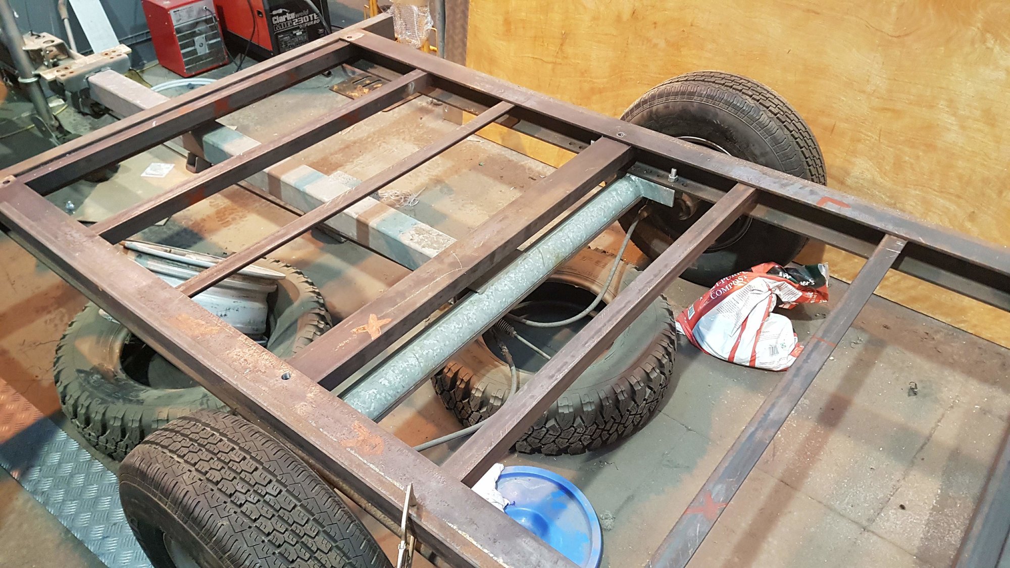

I just bought an 8x4 sheet of 9mm Stokbord - a recycled plastic similar to polypropylene. £60 inc delivery so not bad.
I was going to use it as an underfloor for my trailer instead of wood. It will be exposed to all the road spray so don't want something that will rot.
It is only really a spacer to sit on the cross pieces - there is a sheet of 6mm ali going over the top. The sheet will sit down between the 2 outer rails. You can see the sheet of epoxy coated ply I was intending to use.
The whole floor will be riveted to the cross pieces 6mm angle - then the plastic or ply sheet - then the ali.
I thought the plastic would be a great solution - until I saw a warning about it's thermal expansion. The whole sheet will expand or contract by 2.5mm over 20C! They say not to screw it down tightly and to make screw holes oversize.
I don't think 165 x 6.4mm rivets will allow for much movement...........
Any thoughts? I should imagine the stresses could get quite large if the thing isn't allowed to expand?
I don't want to go back to my sheet of ply but might have to.
