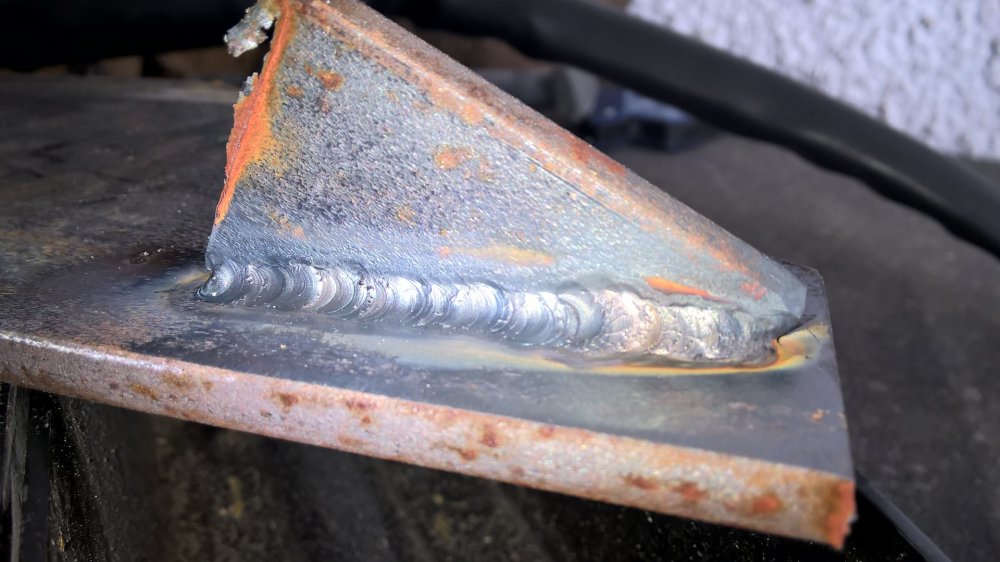

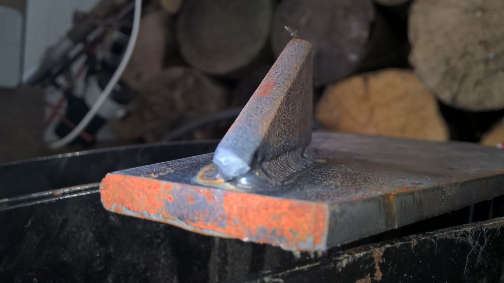

So here's the very first weld I did; sorry @J.B. Welding - you left a nice clean bit of 6mm kicking around and I veritably jumped into my hand when I was looking for something to use. Honest!
Wasn't hot enough so had to take my time and got a bit of undercutting :

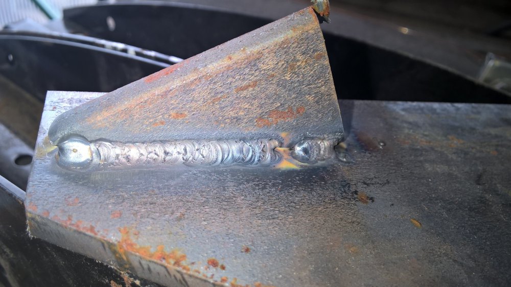

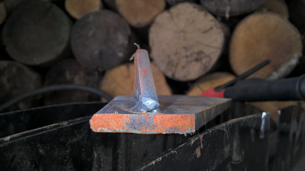

Stuck another ten amps on and ran much more smoothly:
I know there's a lot of you out there who won't be impressed with them there beads, and I know they're nothing special, but the EWM is just so easy to use. They took no effort at all to do and HF is just AMAZING when tacking up.
