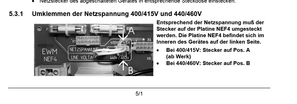

B brockenhammer Member Messages 274 Location Freiburg, Germany Mar 30, 2020 #4 Hi, you can change it internally from 3phase 400/415 to 440/460 by changing the position of a little plug on board NEF4. Netzspannung Triton 260.jpg 222 KB · Views: 105
Jim Davey R H Davey Welding Supplies Ltd Messages 5,736 Location Southampton Apr 5, 2020 #5 I don’t think that’s going to help. I believe he was looking for a 240v set.
