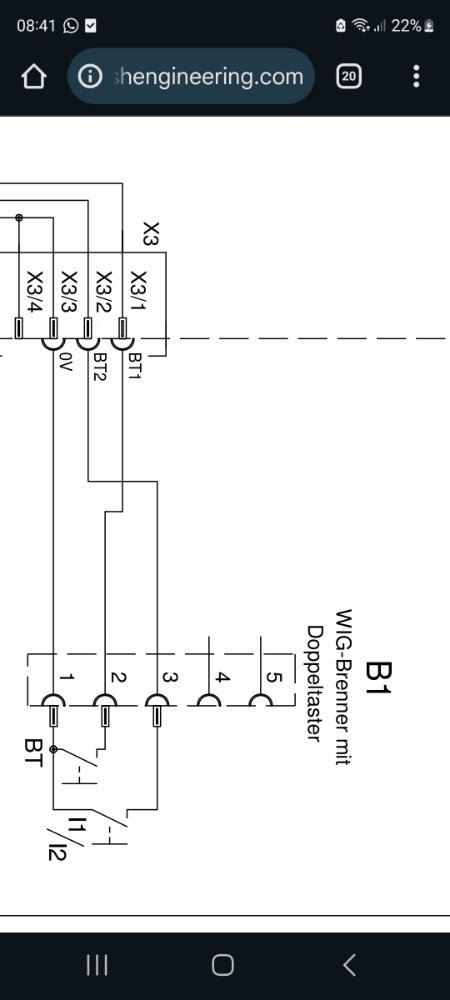

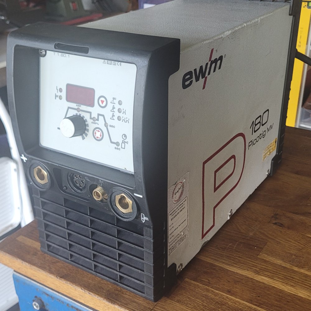

I have a EWM Picotig 180 but it came with the wrong torch, at least the connection is wrong.
Picotig has a tuchel 5 pin but only 3 pins are wired (I attach it's diagram).

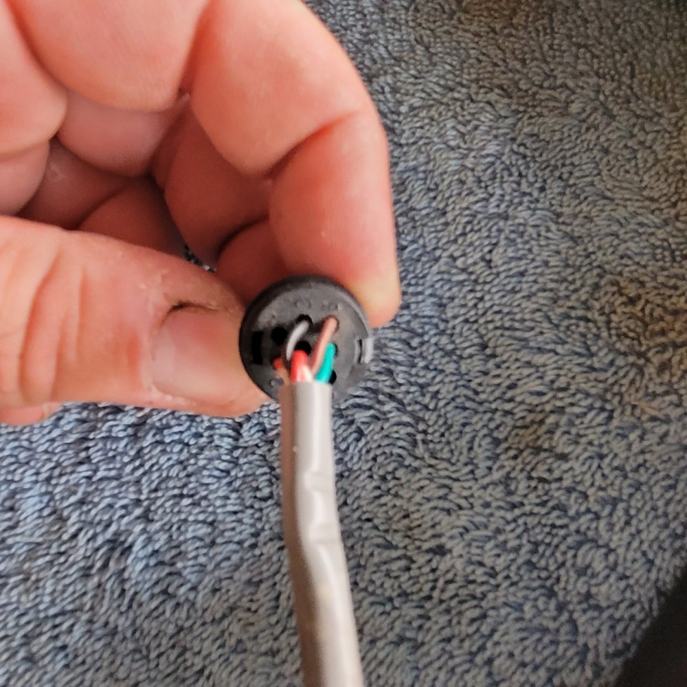

As you can see the torch has a micro connector with 5 wires, brown, black and green (in the "3 pins side") and red and white (in the "2 pins side).
I have bough a tuchel connector to make this torch working on my EWM.

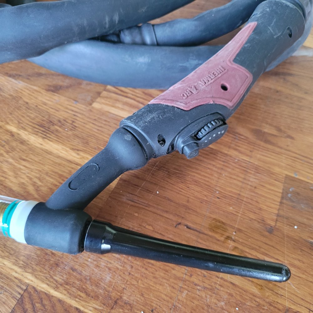

This picotig can work with standard 1 button torches and with 2 buttons torches as well.
My torch has 1 button (and a kind of potentiometer control).
Please I need help to wire the tuchel properly!
Of course, this is my first time doing this
Thank you very much in advance!!
