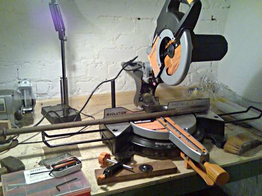

Hi,
After mulling over the pro's and cons of getting a bandsaw (the Axminster CMB115 @ £156) or a disc saw, I ended up getting one of these Rage 3 cut-anything-under-the-sun things from MachineMart at £153 incl. vat.
Reasons being: going for something at 150quid, I guess a motor with a whizzing saw has less to go wrong than a bandsaw with lots of fiddly bits to keep the blade straight.
Also, I do have a need to cut up chunks of wood when I rebuild an outbuilding in a month or two.
Out of the box: There were several screws missing from the plastic bits either side of the cutting line - I replaced the lot with socket screws. The mitre tilting 'bearing' was a bit wobbly, but tightening the big nut at the back seemed to fix that. The workpiece clamp is just cr@p (pictured in front of the saw on a bit of hardwood), I fettled it a bit, but it's still poor. To be really safe, you need some better clamps.
There's a sliding end stop (not in the picture) which fits on the 8mm dia entension bars on either side of the saw - this is a waste of space too. There's two holes in a bit of cast aluminium which slides over those bars, to cut longer pieces you have to remove the bars (which is a pain), so I hacksawed a slot in one side so it could pivot on one bar and move out of the way.
Cutting... well, it makes mincemeat of soft and hard woods, aluminium offers little resistance. Mild steel cuts pretty well, although I found the blade would sometimes 'resonate' and make a wider cut - this seemed more likely to happen when you are taking it steady (pushing down harder seems to cut cleaner).
I cut 40mm, 5mm thick angle and 20mm solid bar with no trouble.
I had a bit of 12mm bar (which was probably rebar) which it didn't like at all - so I guess anything with a bit of harness to it is a no-no.
The "Frikkin' Layzer" sight-line is cool, as long as you remember it's on one side of the blade - so you can easily be 3mm off (doh!).
All-in-all, I'm pretty happy with it at the price. It should last a while since it's just for 'hobby' use - if you cut metal for a living, I guess it wouldn't last a month.
