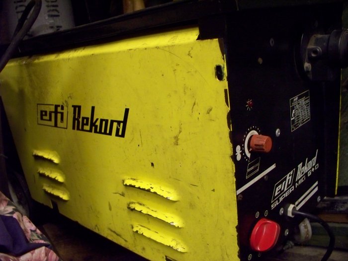

stupid question how do you measure the length of a euro torch mine seems to measure from euro fitting to end of torch just short of 3 metres is this classed as a 3 metre torch i am looking to buy a longer torch 4 metres would be nice would i have any change in settings needed with said torch

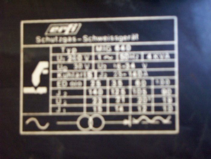

mig is a ERFI 640 140amps i have had it from new so now 25years old

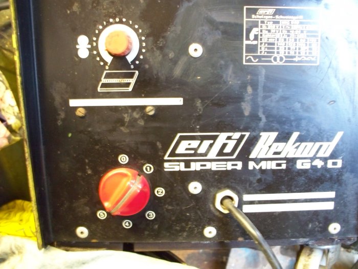

i did add a fan so now it's a turbo did make a big differance to duty cycle on top amps i know ERFI made a 640 and a 700 was a bigger case one other point is on the amps switch it's rotary 1 to 6 or 7 but only works on 1 to 6 7 is dead always been like it anybody any ideas thanks to all
. If you not happy working on mains equipment then UNPLUG an just look with tourch, gentle poking to find any brakes. Any pics of back of switch might help or even a schmatic
