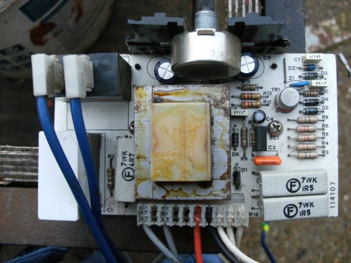

Just started doing my euro conversion on my sealey 170/1 and already have the solenoid in the welder,so I have a couple of questions.firstly I have fitted the plastic flange but don't understand how the round brass part is secured what the gun screws onto.secondly do I connect a thick earth wire from the rectifier to the threaded brass bar.last of all where do the two blue wires connect to off the connector,I removed my old gun a few months ago and don't exactly remember where the wires went,but have found a spare connection on gas solenoid and another piggy back spade terminal. Any help appreciated.
