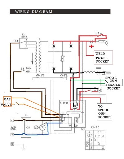

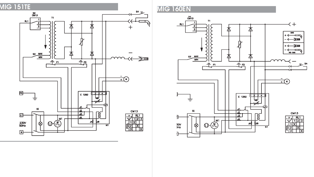

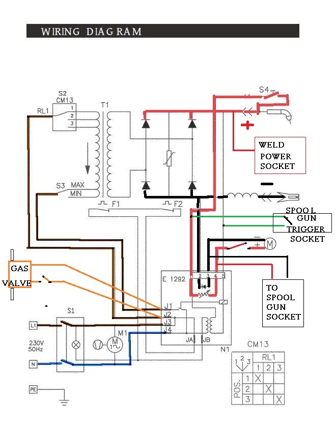

Hi I have a Clarke mig 151 te, I'm thinking of maybe fitting euro torch conversation, with this I hope to fit spoolgun on occasion for aluminium welding, but on looking at the spoolgun euro connector closely I noticed that there is a separate connector for the spoolgun motor and a spoolgun gun switch is needed to connect this to the wire speed controller, has anyone fitted one of these spoolgun switches?
From what I have read on the net, controlling the spoolgun motor from the welders speed controller isn't always very affective, especially if the mig in question didn't originally have this function in the first place, as in my 151? even though there seems to be a switch to kit to do this?
Any help givin would be gratefully appreciated ta
