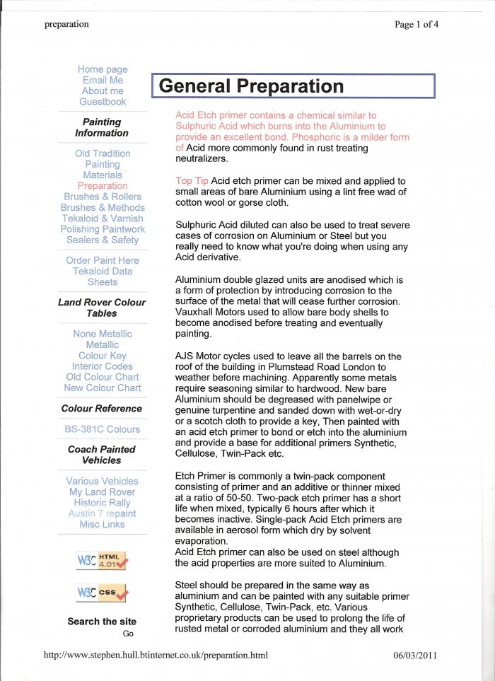

Get them from your local paint factors. I use the Upol acid etch and it is good.
etch is a one part component .Were acid etch is a two pack component.Acid etch is your best bet.Acid etch or etch is not for aluminium.epoxy is for aluminium.
ive used 2k acid etch on aluminium and steel for the last 30 years , the acid bites into the metal giving a good key . single etch isnt up to much but 2k most cetainly is . epoxy may be taking over as advances are madeetch is a one part component .Were acid etch is a two pack component.Acid etch is your best bet.Acid etch or etch is not for aluminium.epoxy is for aluminium.
