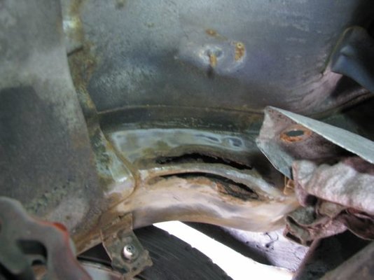

I got the back box off, and cleaned up around the chassis hole with emery until it was mostly clean metal, just the odd spot of stubborn paint that I couldn't shift. I'd decided to put two plates on, one vertical and one horizontal and the top weld on the vertical was going to be the killer.

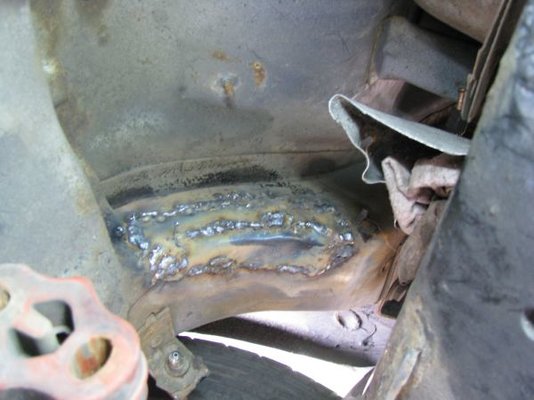

that bit of rag over to the right is stuffed into the end of the exhaust pipe to stop bits falling in. The shiny metal around it is the aluminium (I think) heat-shield that I'd folded back out of the way. I was reaching up almost full stretch, couldn't see where I was going as my arm blocked my view, so it was mostly done by 'feel'. Run some weld, have a close look, run some more weld, look again, fill in burn-through holes, have another look. It's not pretty but it's solid...

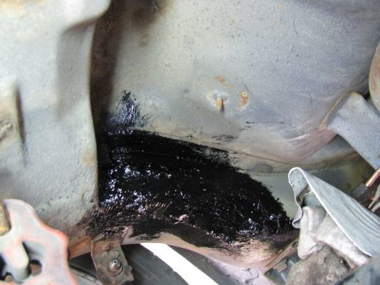

and now it's had the underseal slapped on it's looking a lot better...

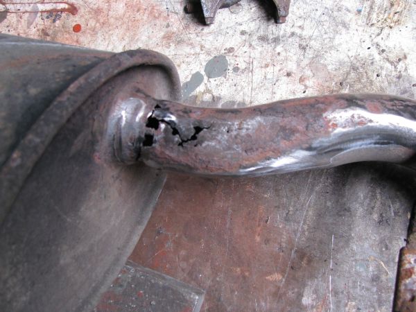

Now for the exhaust, done in the workshop so no problems with the weather, but it wasn't exactly 'pin-holes'...

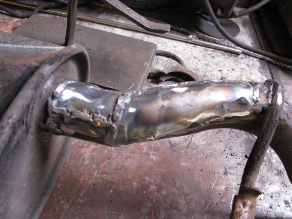

as it needed a biggish plate with multiple curves, I decided on three smaller plates. Two of them were around 3cm wide and formed a new 'collar' welded on to the thick joint in the front face of the box. The final piece covered all of the rusty stuff forward to the front hanger-bracket. Again it's not pretty but it'll last at least a year and my son plans to scrap the car next year.
six hours in total!
