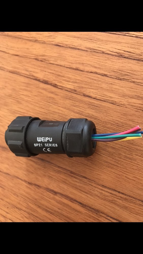

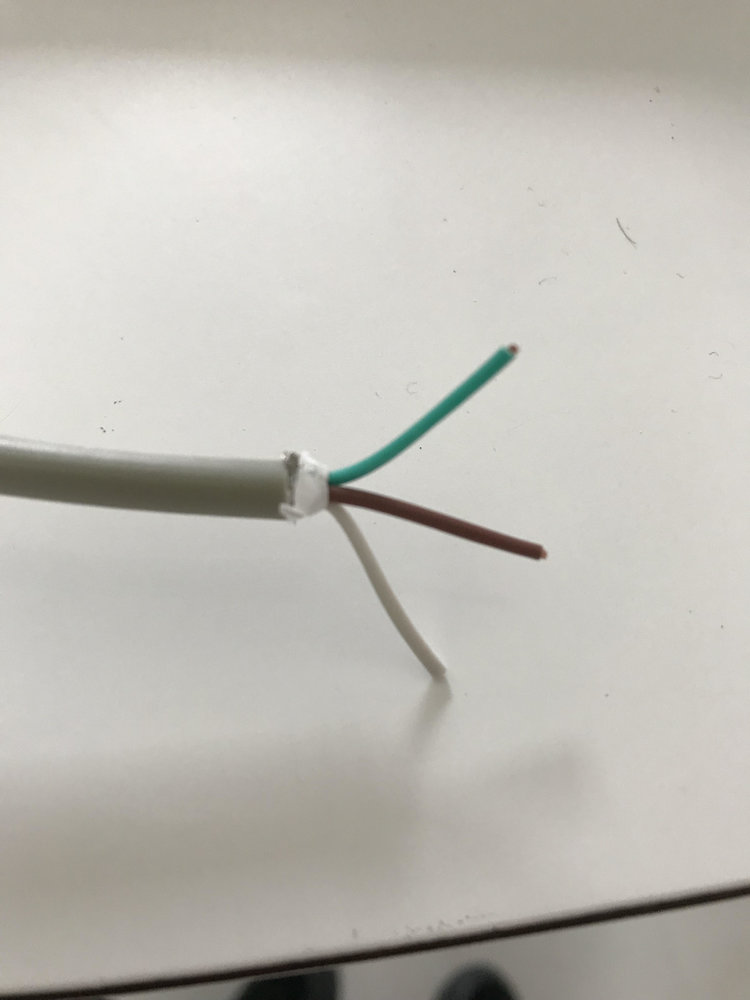

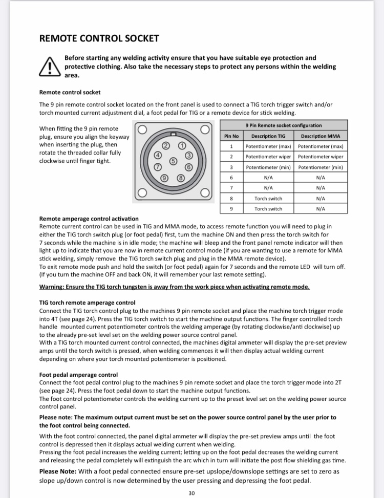

I bought a Jasic 200p AC/DC last year, it came with an Esab SR26 torch . How do I fit the Esab torch to the Jasic plug? The Esab torch although new had no connector plug on it.
The Jasic plug has 9 pins and five wires whilst the Esab torch only has three wires. Hope this makes sense. Thanks
