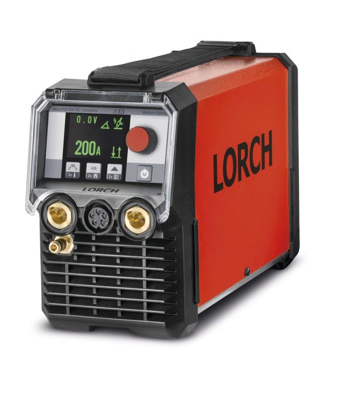

I am looking for tig welder for stainless steel and pipe welding.which tig welder is batter?Esab Renegade or Lorch Micortig ?
esba design look batter but only have 999hz pulse , Lorch Micortig can go to 5000hz, but more then 1000hz is it matter?
I've not used the esab, but used the lorch micortig quite a bit.
The lorch is one of the best tig and stick units ever made, in my eyes. Super efficient on electric, very easy to set up, the HF is very powerful, it's a very smooth arc, its drop rated, its multi voltage... I could go on and on.
Not many people ever have a use for 1000hz upwards.
Oh and its made in Germany, and people know how to repair them when they go wrong. Not so sure you could say that about the esab, its chinese and historically esab haven't been great at service support.
