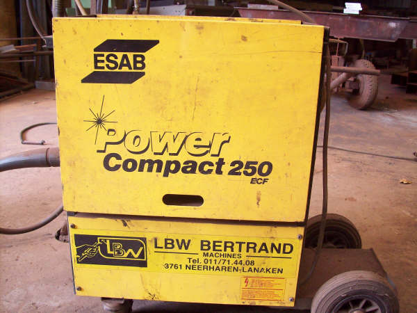

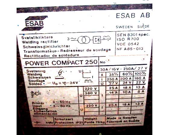

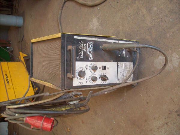

I'm thinking of buying a secondhand ESAB POWER compact 250 ECF for just over 400euro.
Is it a reliable/good model? I'm guessing it can handle about 2 centimeters thickness?

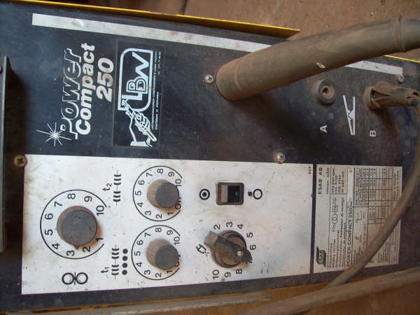

I'm going to test it soon, I have a welding degree and quite a few certificates but it has been 4 years since I last touched a MIG so I'm hoping I'll pick it back up quick enough to judge its performance.
When I'm testing this thing, what parts should I look at to ensure it wont die on me anytime soon?
Ideally I would want to set myself up with it to weld aluminium, steel and stainless, I am told that(and my question is if what I am told is true or not):
For aluminium: I need to feed some sort of tube through the torch to lessen its diameter and I need to hook on different gas and wire.
For stainless: I need different gas and filled core wire which are a costly 340euro's per roll.
Also what kind of extra costs should I be aware of?
Please excuse my lack of terminology, english is my second language and to be honest even my dutch welding terminology is very rusty.
