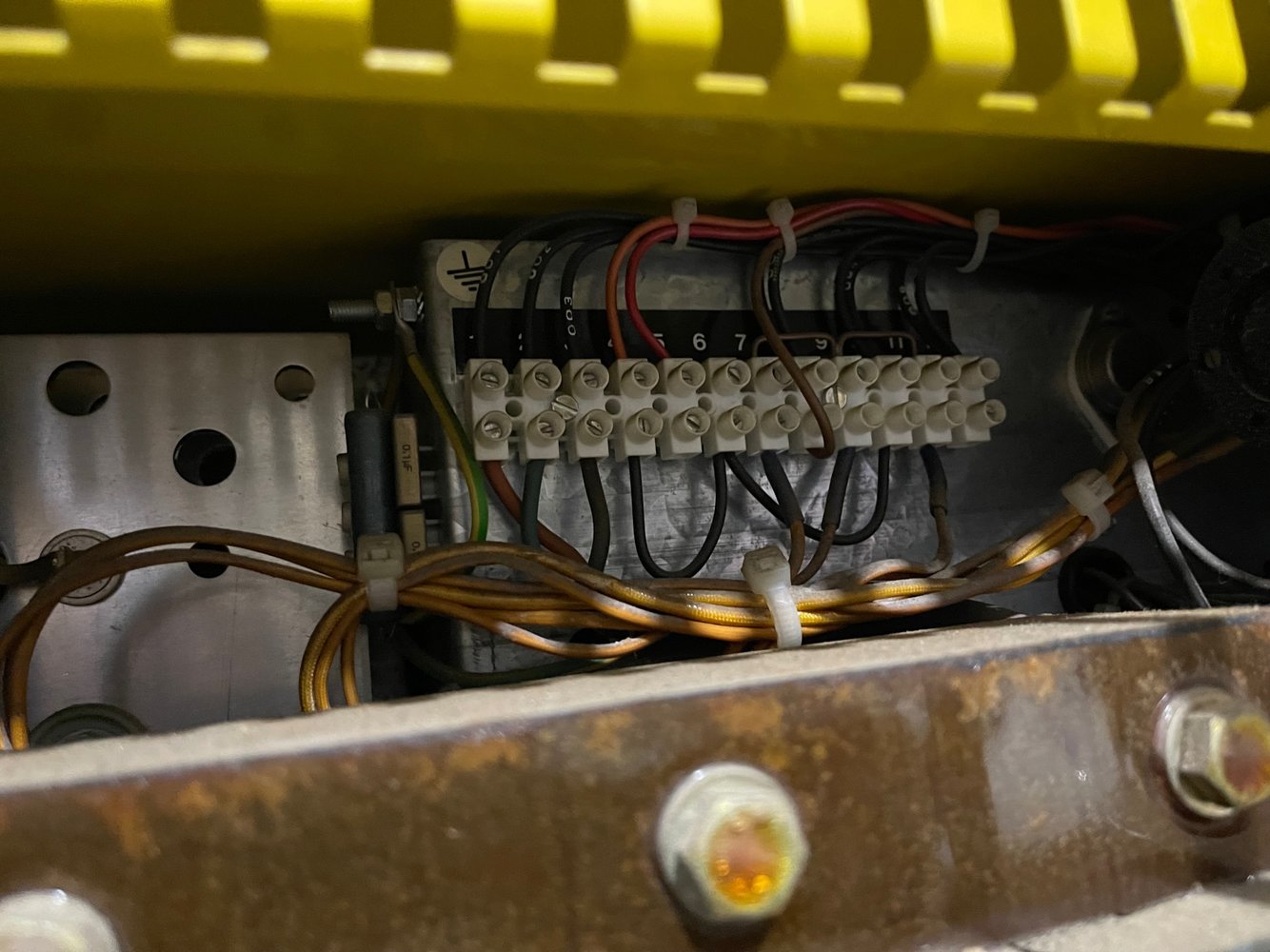

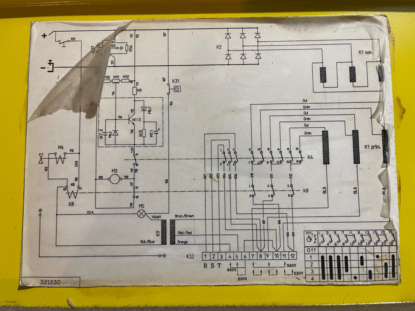

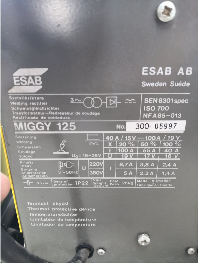

I purchased second hand Miggy 125 that is set on three phase (380v). I can see on schematics inside that it can be converted to 220V.
Does it mean that I can just change shortcuts according to scheme and use it as a single phase welder? I assume that I have to change cable to monophase and connect zero and phase to position 1 and 2 ?
