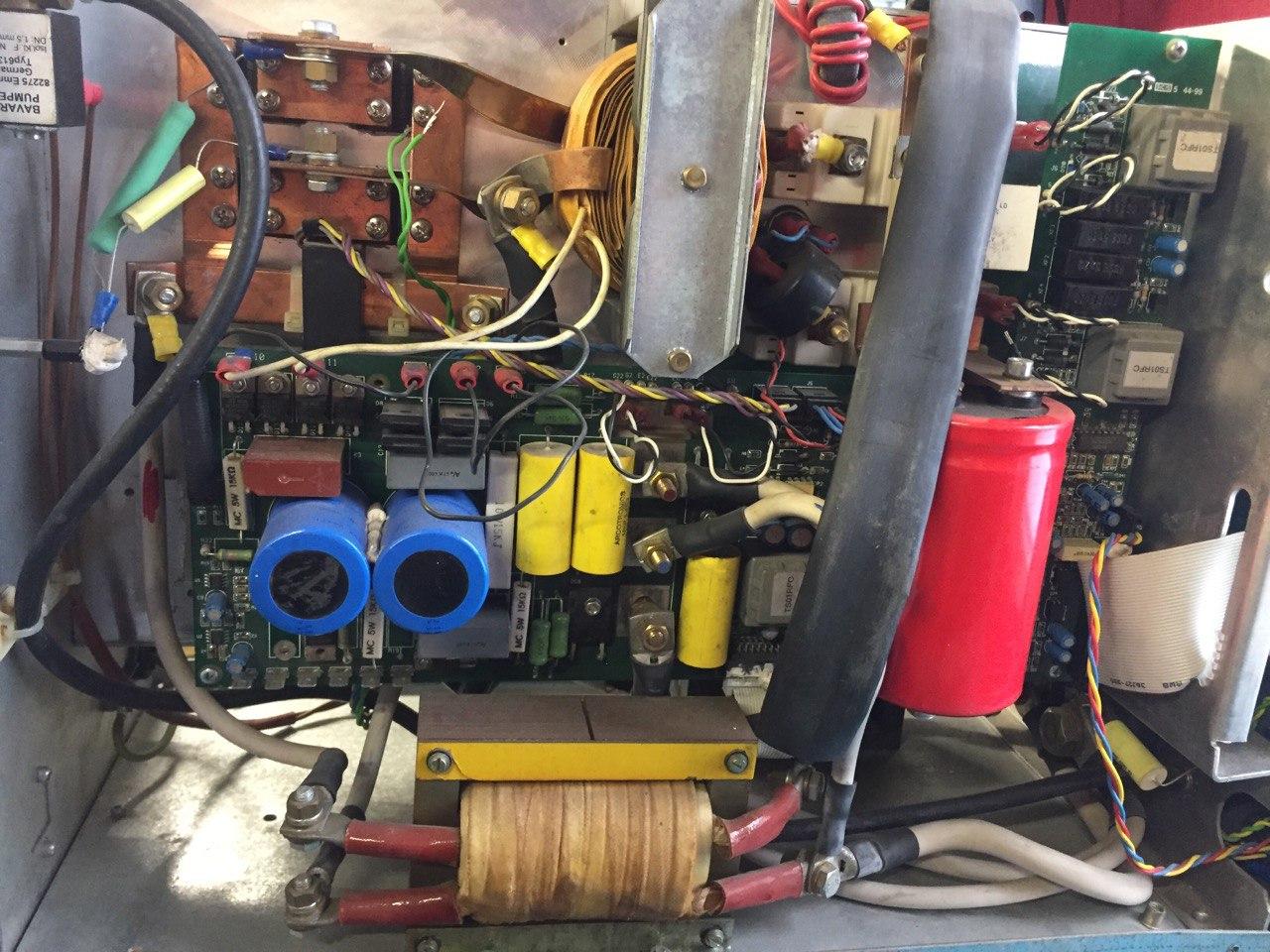

I bought a broken Esab DTH 180 AC/DC. The seller told me it was broken. A transformer was broken off the PCB after it dropped. After some reverse engineering i got the power back on. But the seller failed to tell me that he removed a couple of power resistors and a transistor. So i'm searching for some manuals, somebody with a similar machine or other hints what's missing.
Because for the first time ever i can't find anything on google or wherever.
It's from Ukraine, looks like Murex.
Q3 and R19 are missing. And everything is missing that was supposed to be connected to the 6 plugs on the bottom. I think some power resistors are missing because there are some empty spots on the aluminium cooling plate.
Any help is much appriciated, thanks in advance.
