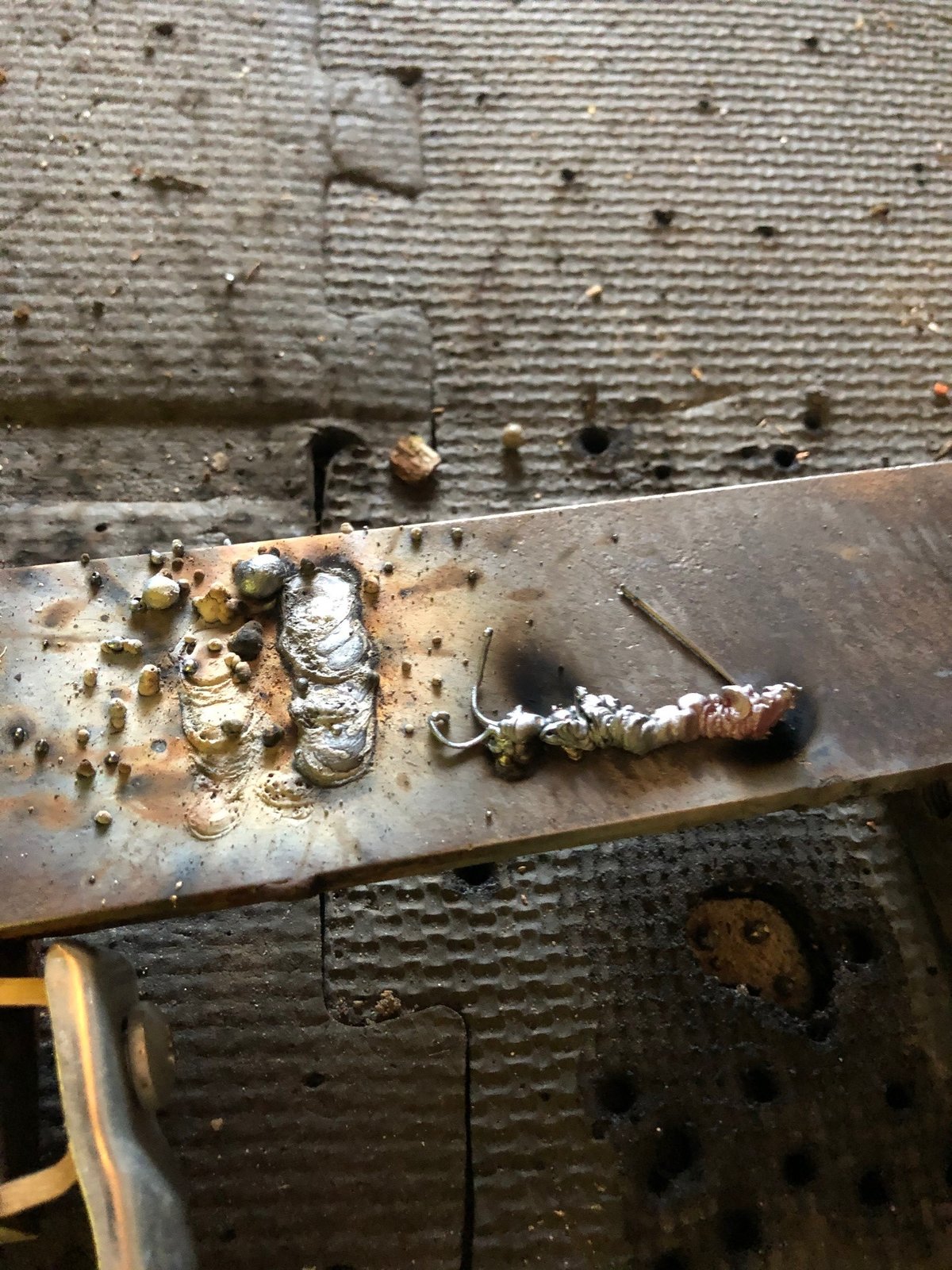

I picked up an ESAB C200i welder a few months ago, i was told it wasnt operational and he was quoted £700 to fix it. So, took it home, opened it up and low and behind, the LCD panel was disconnected on the front. Reconnected it, it booted straight back up and welded perfectly on gasless wire (As perfectly as a gasless wire weld can be).

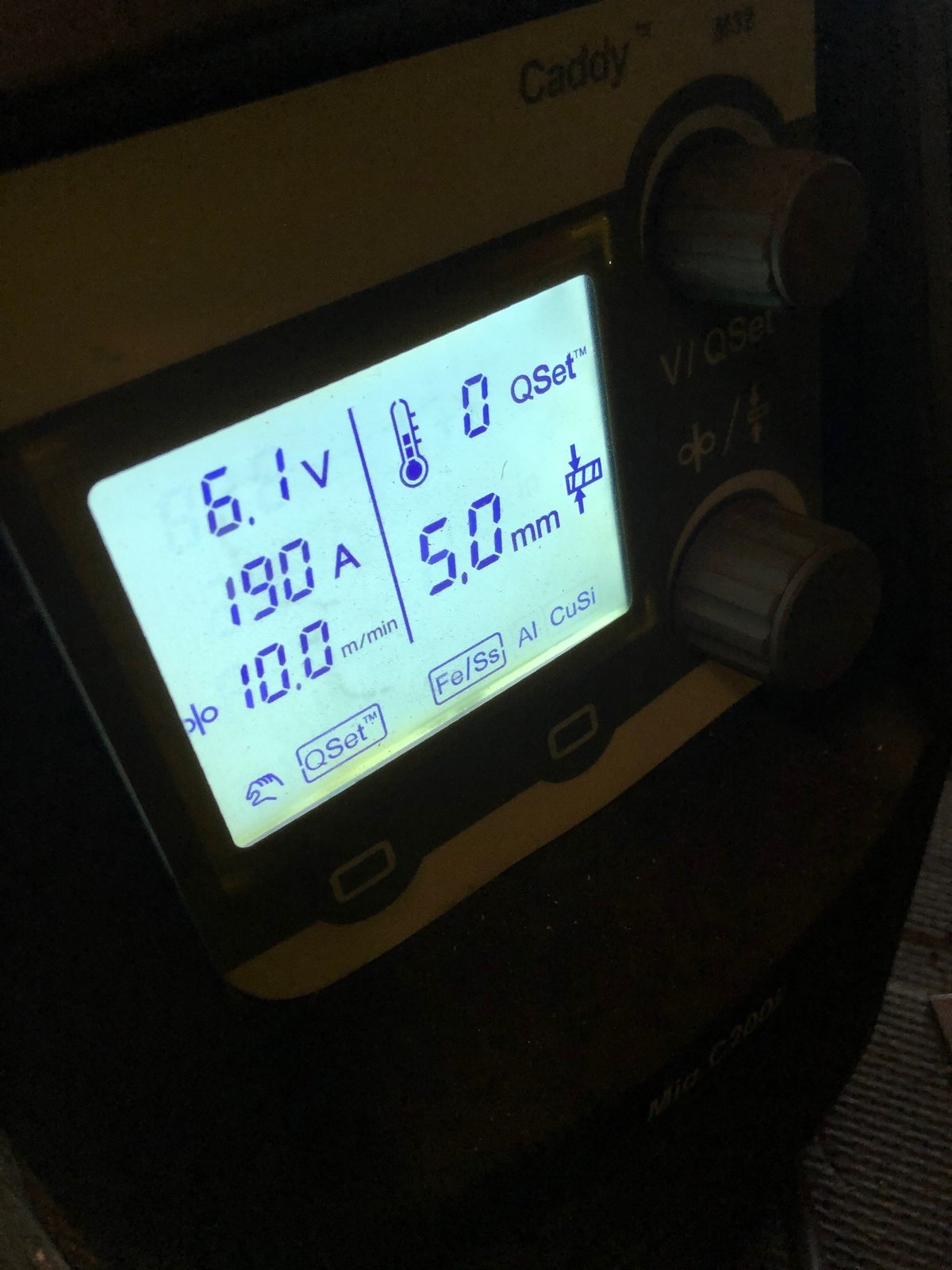

I then swapped it out for some proper Esab 12.51 Autrod wire in, reversed the polarity in the machine (Then reversed it back as the previous user apparently hadn't bothered), connected up some pure C02 and low and behold, it welded like it was set to about 50 amps. I can just get away with a weld on some 0.8-1mm plate when cranked up to 19v. It states its welding at 190a on the screen (Photo attached of the display whilst welding).
So i took some readings, and it turns out open circuit voltage is 44.4v (Service manual states it should be 58v), and DC bus voltage is around 310-320v from memory, again manual states it should be 390-400V. Im assuming this is my problem.

The two photos show LCD display whilst welding, and an example of a gasless weld on the left, VS the same settings with the gas wire on the right.
