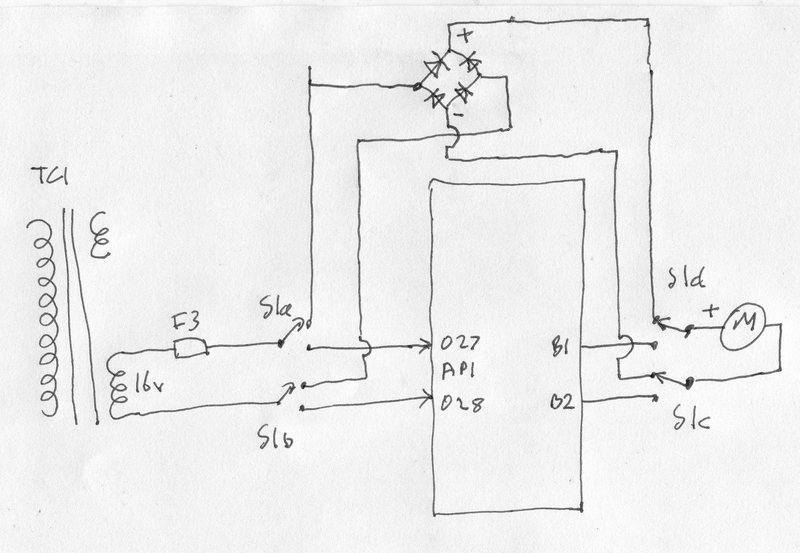

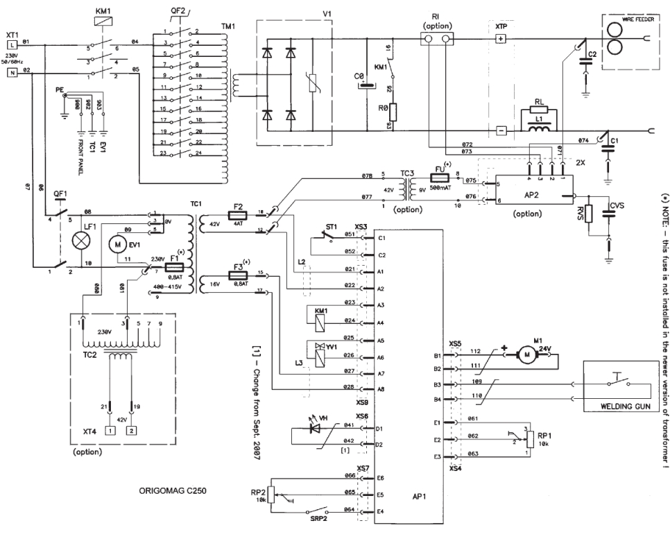

Apologies for the curveball thinking, but I'm currently short or a Euro Torch, so was pondering the thought of how I could get around the need for one when testing the wire feed motors?
Now, I could simply hook up a power supply and try them out, but I don't have a 42v output unfortunately.
I'd also toyed with the idea of installing a wire "inch" switch somehow, so I could feed the wire through without wasting gas, as i know I'll forget to turn the cylinder regulator off when I need to..
Anyone successfully installed one? It cant be that hard surely?
