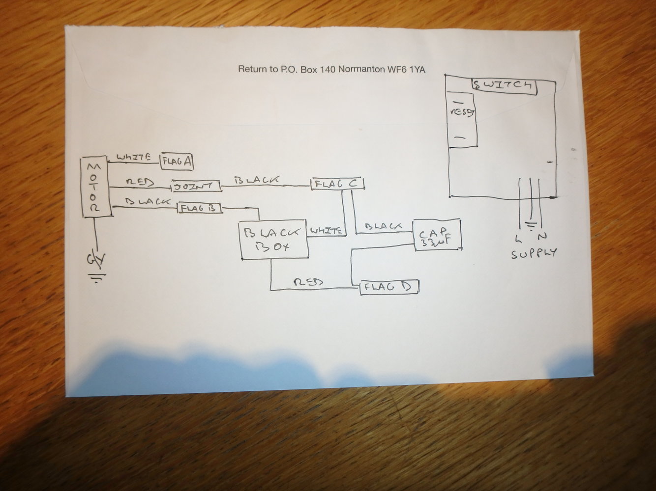

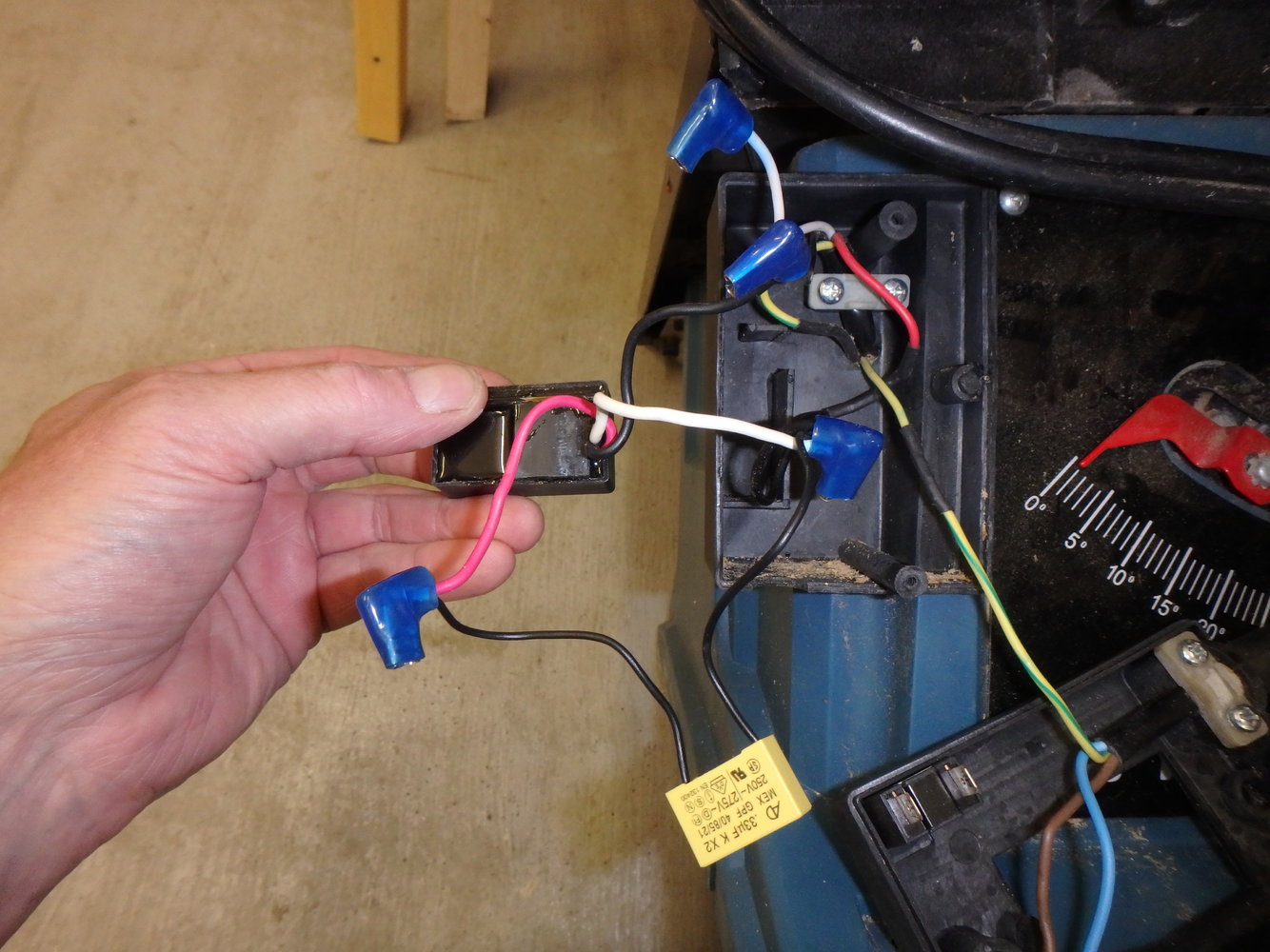

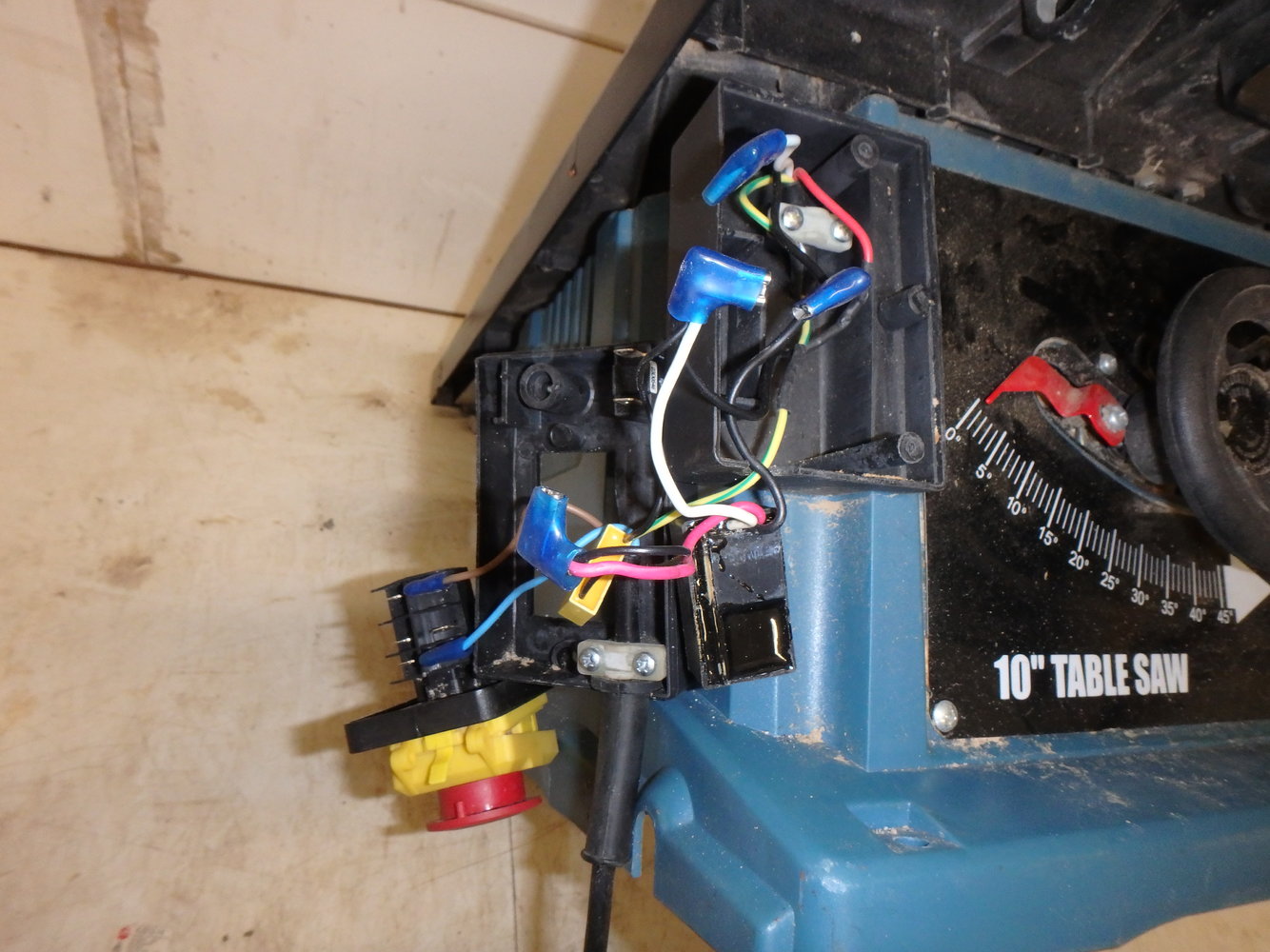

Put it in the freebies section with your usual £15 postage....I've been given one of these, the switch has been opened and the connectors disconnected. Online searching doesn't provide me with anything useful.
Has anyone got a working one they could take a picture of please? Failing that, what to do with this lot:
I hear what you're saying, but it still screams "Bushes!" to me...To expand on the motor's state. When connected to the power it hummed but no more, when I span it up with a stick it felt very notchy and still didn't spin unaided. The brushes look ok, plenty of length and properly shaped ends. The motor doesn't smell burnt.
It's got a nice table top, there's carrying holes designed in. I was hoping it might be an upgrade to my current shed saw but it looks to be a tediously long job swapping all the fittings over for no great gain.
