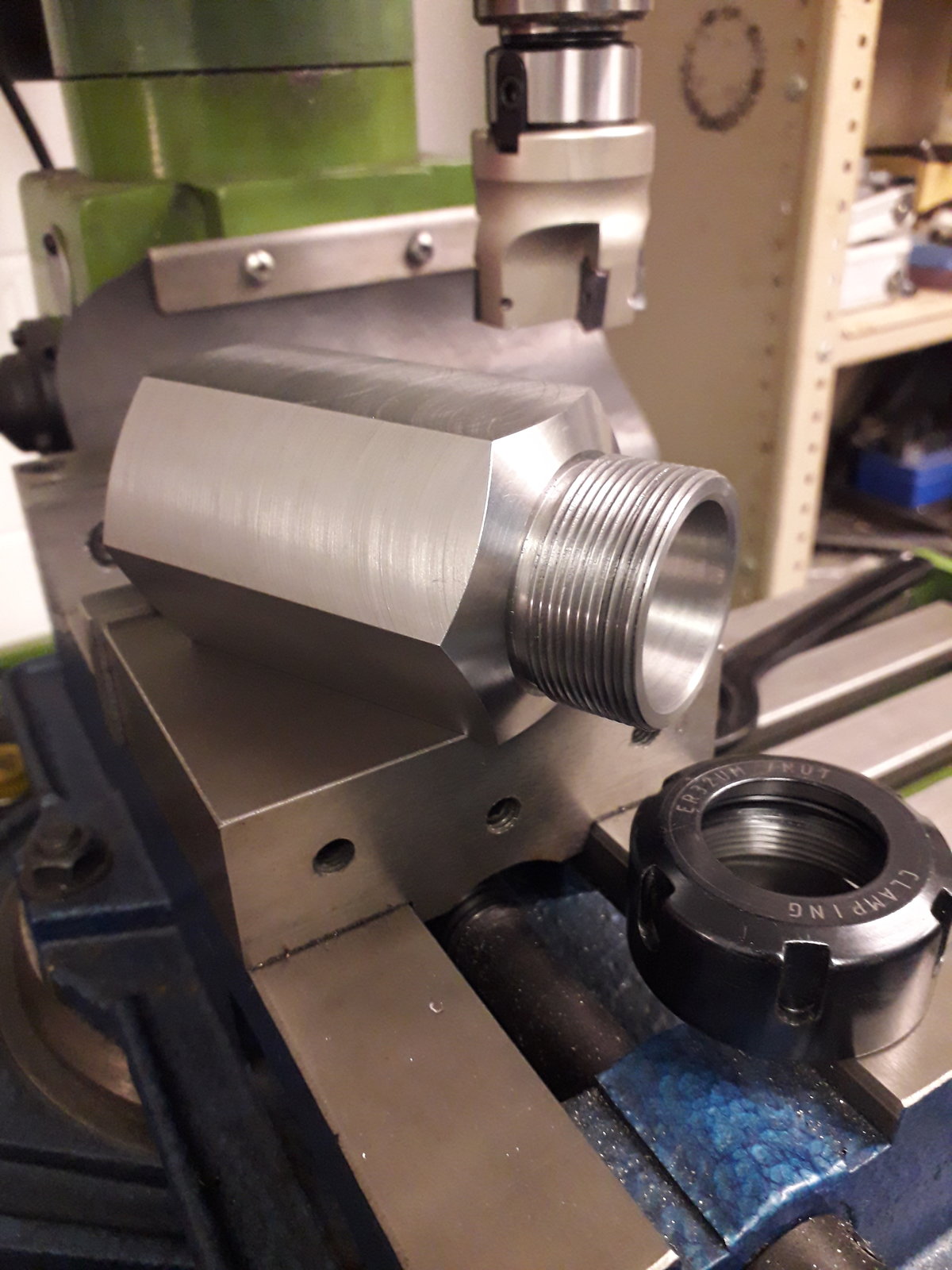

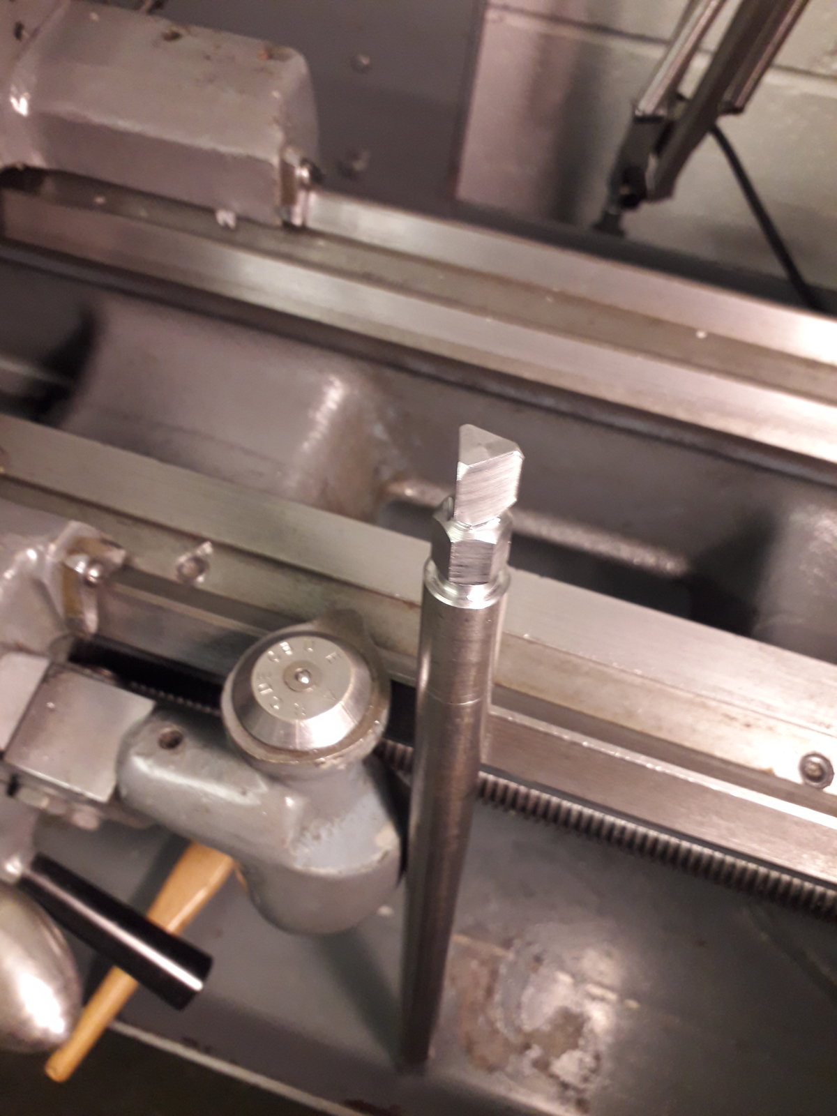

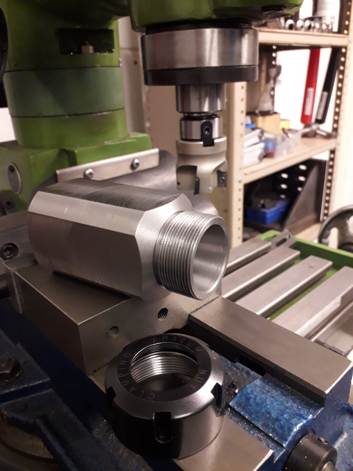

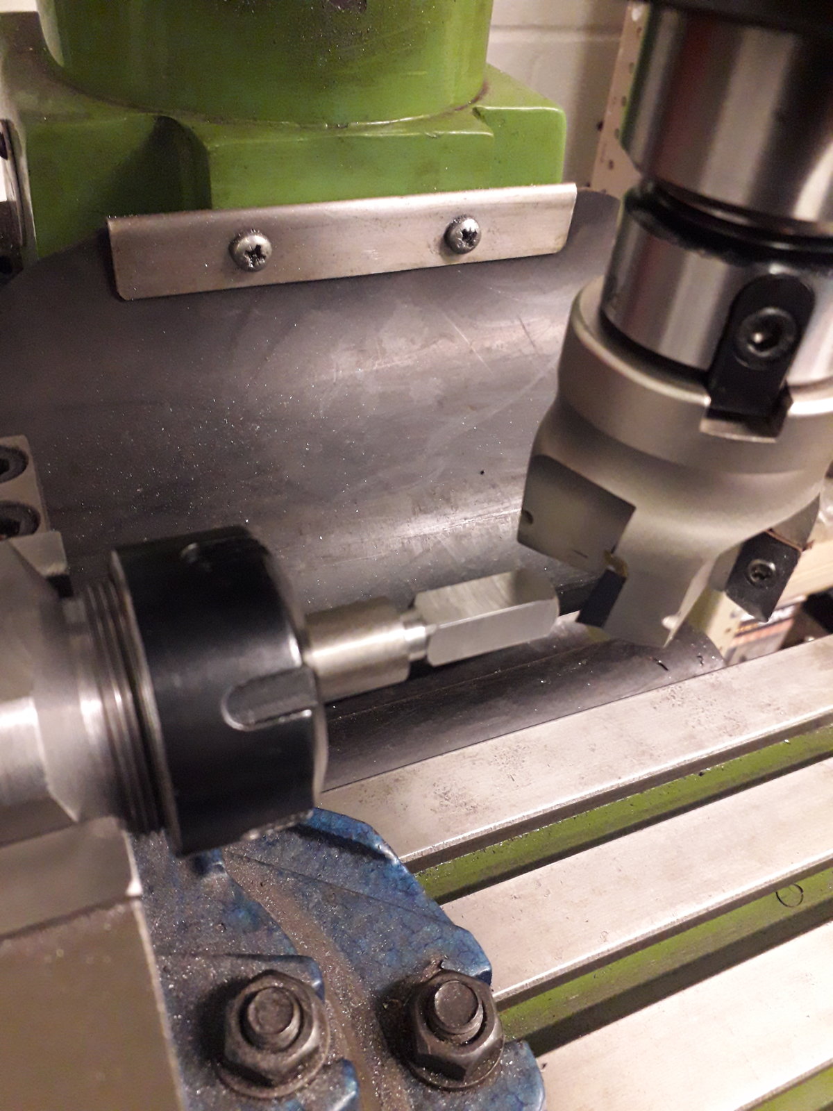

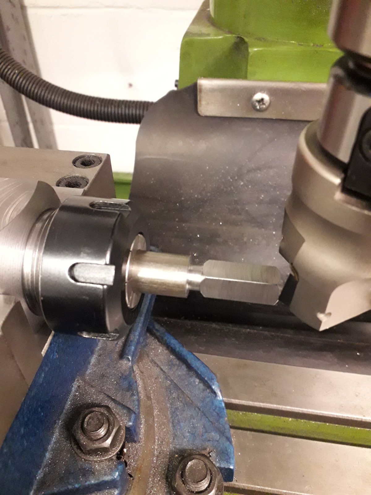

Very nice i made the same setSo pleased with the square one I decided to make a hexagonal one..
So now i can make round bar hexagonal and triangular..
Mill is the warco version. Lathe is Boxford.Very nice i made the same set
That mill is the same as mine lathe looks like a Boxford

I made an indexing one that can do 2, 3, 4, 6 and 12 ways, mine is smaller using a er20 spindle, but you can get er32 spindles too
very handy for making smaller size hexagon nuts with![]()

By the length of the machined bar they are hollow right through? Have you a depth stop to fit inside or is that next?
Both blocks are within 3 thou. Close enough for my needs and not bad as i set the hex one up off the side of a big nut by eye.Nice work. I have fancied making similar but haven't got around to it. What concentricity did you achieve with the bore?
