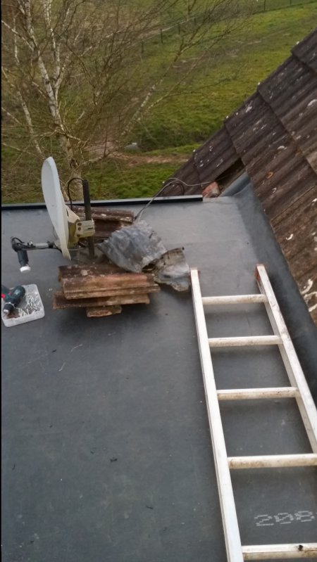

Oh the shed was finished outside ages ago. Lol just finally finished board out inside of the roof after sticking in 4 inch of insulation.Can't help with the roof but can I assume the shed is moving along?

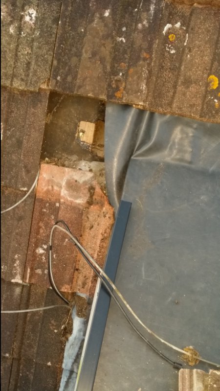

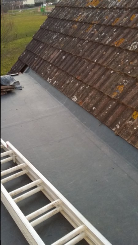

Yeah I removed the bottom two rows of tiles but my main concern was how to replace the under tile felt that is over 40 years old and very brittle. I need to lift that to get the epdm underneath it. I guess it could do with a complete tile strip. Some new under tile felt fitted and re battened one day. But I am knackered after 2 days on the roof so I guess it will have to wait.Why not go under the eaves have you no room?

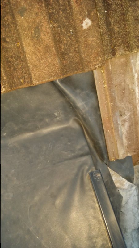

That's my main problem as the epdm has to go in two directions it's proving a headache.you would have to follow the way of the lead drain off in one of the vids
epdm then your lead then the epdm over the top of it however i wouldnt advise sticking it to the tile

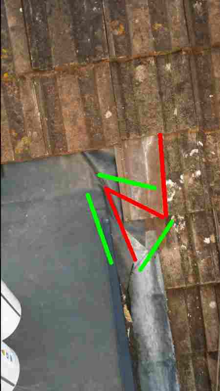

I thought 8 had watched those two vids gaz. Problem is the epdm needs to go under the felt coming from the ridge but over the tile that is below flat roof height. I think I need to invest in a roll of joint sealer and black glue...lolyou would have to follow the way of the lead drain off in one of the vids
easisest way is to take out the first lath batern board up a little across the front fix your epdm to the board this seals up to that point
your felt drops back over it
there is a metal trim that joins from both materials
at the corners to the roof id still be using the method of fixing to your soakers with the epdm just needs longer soakers
