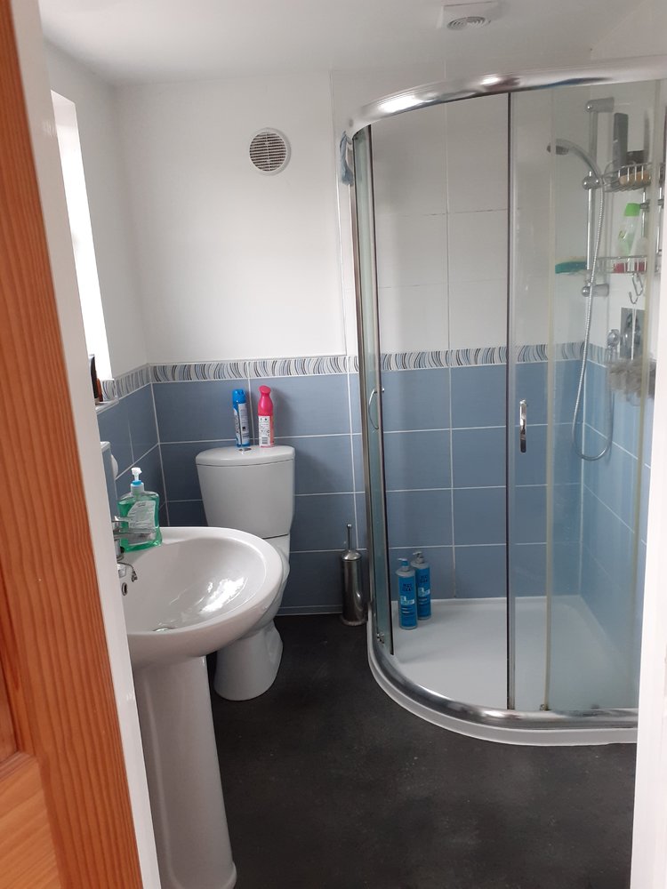

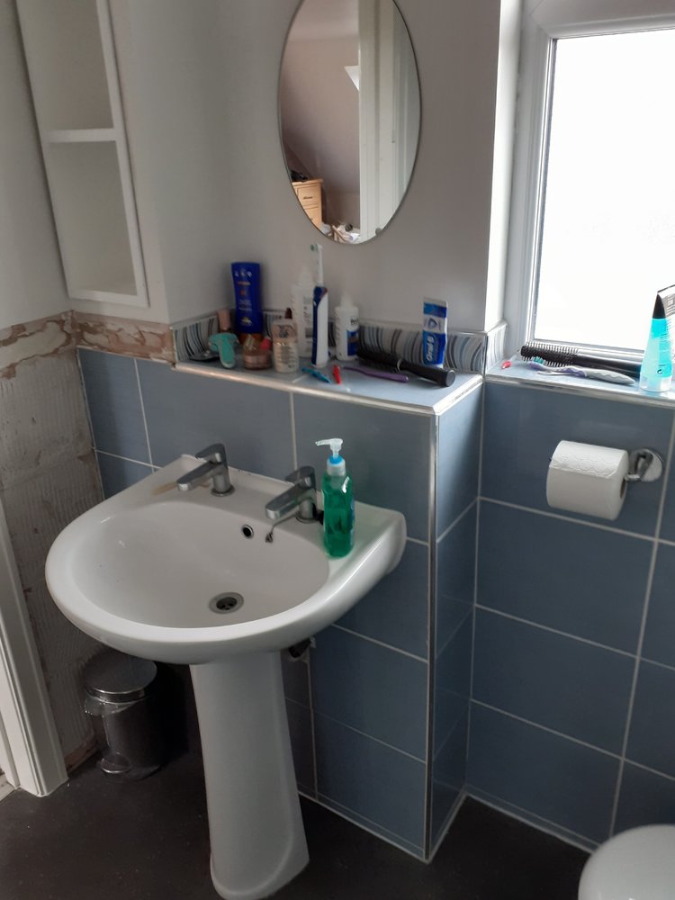

I'm just aabout to redo our loft conversion ensuite as its looking a bit tired now but by removing the tiles it will destroy the plasterboard.The problem I'm having is that it is impossible to find a plasterer at the moment.The board I can probably replace myself but it will need skimming to bring level with the existing board.Now I'll have a go at most things but plastering is one thing I will never attempt again. I've measured the thickness of the skimmed board and it measures 14mm, now with plasterboard at 12.5mm how much of a bodge would it be to use 1.5mm wood between the plasterboard and studs then smooth the joint with filler.Most of the board will be covered by new tiles apart from maybe two inches around the edges where I won't take the tiles as far as they were previously. Any other suggestions.
