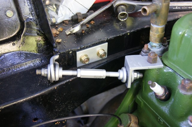

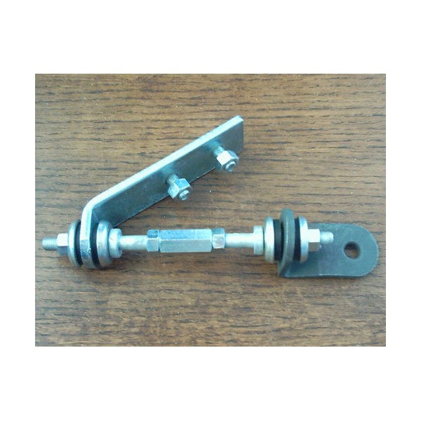

I've managed to tear a new rubber engine mount (on a Morris Minor!!!!!) and have knocked up a rod to tie the top of the engine through a rubber bush to limit movement, rather like the one used on Morris 1000s. Now, if I stand at the front of the car the engine rotates the crank clockwise. The tie rod on the Morris 1000 goes from the top of the engine to above the (UK) drivers' feet. Am I correct in thinking that this tie rod is going to go under compression? I've been forced to put my own one to the other side of the engine bay. Carb is off at the mo so I can't see what it does.
The reason for my concern is that me new engine has only one stud available to mount the tie onto and that if the rod was under compression it might kink the tie rod around the rubber bush. I can't for the life of me see why the factory used the same tie rod under compression, unless I'm turning thick and have got it all wrong.
This is the factory design. Is it being pushed or pulled???
Mine is more like this...
