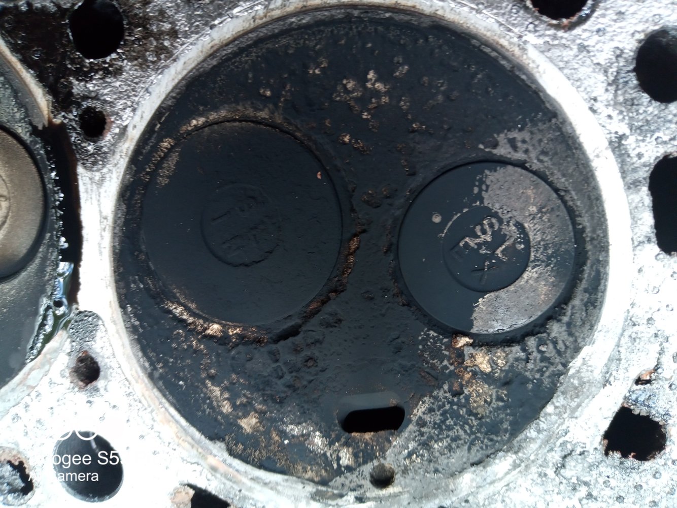

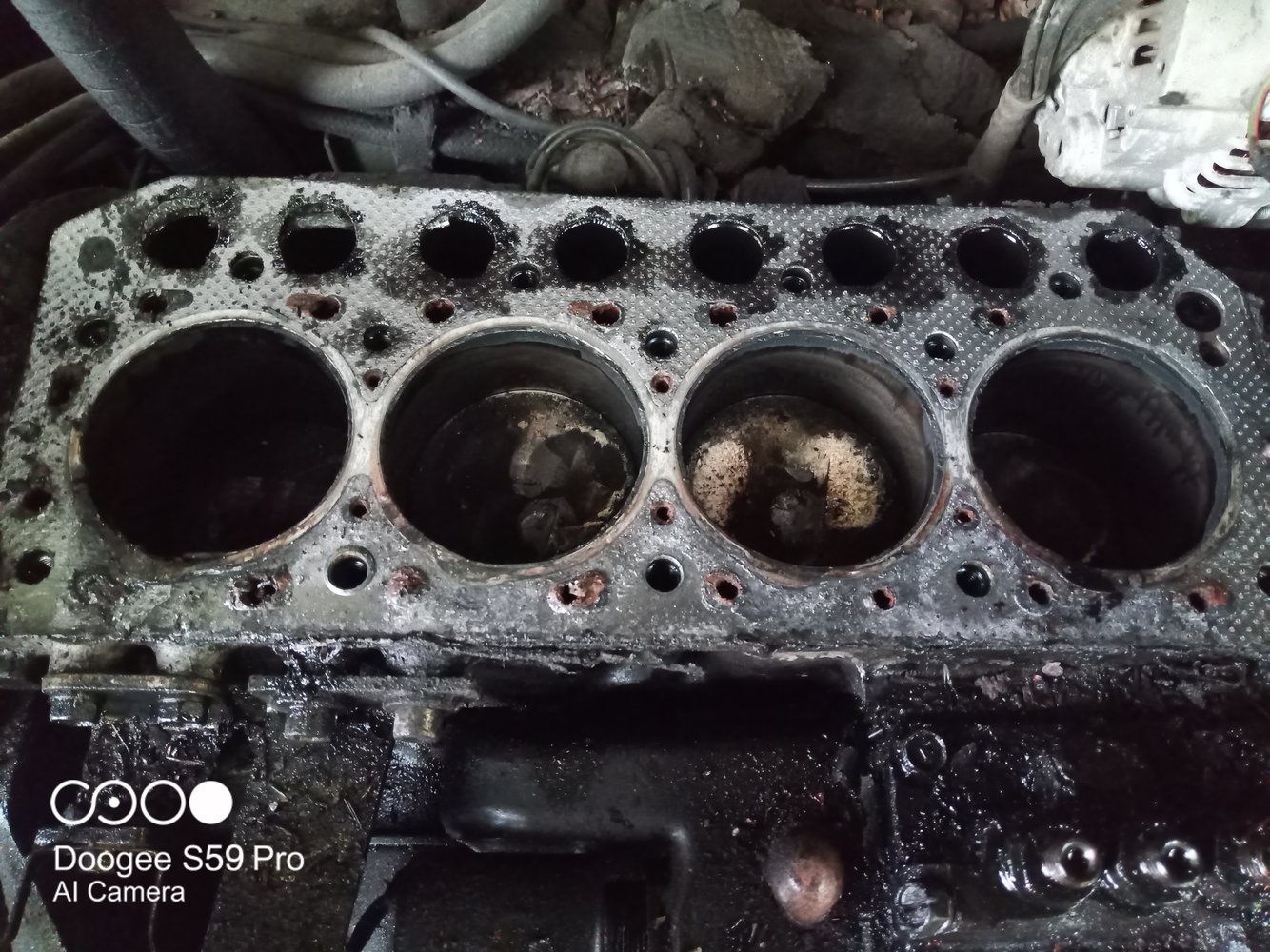

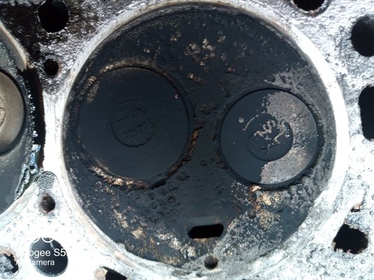

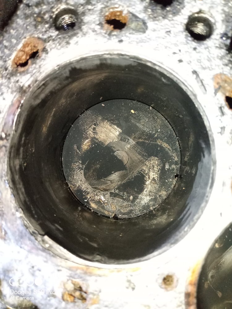

Head gasket blown, head pock marked & a crack on one cylinder between glow plug & injector port, piston damaged & just generally worn out.
