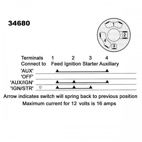

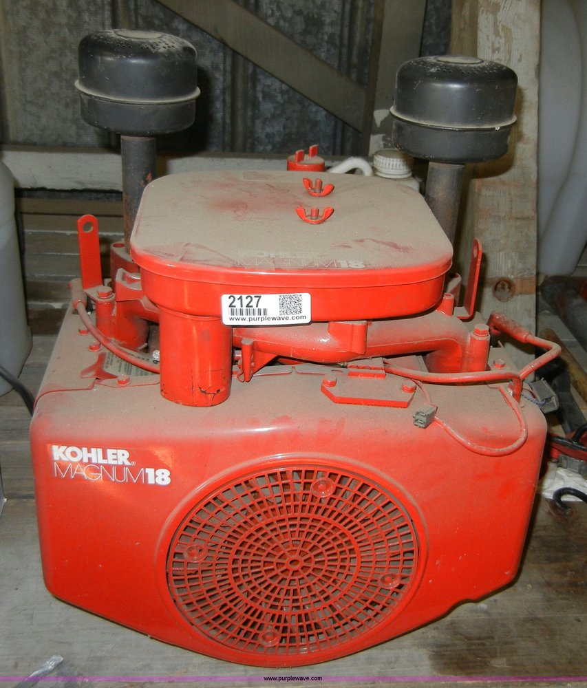

Ok so I have a Kohler M18 engine in my Argocat and finally got some time to finish the project last stage being wiring , I had no loom as it came in a kit of parts basically 2 machines to make one
engine is like this
I have a lucas ignition key

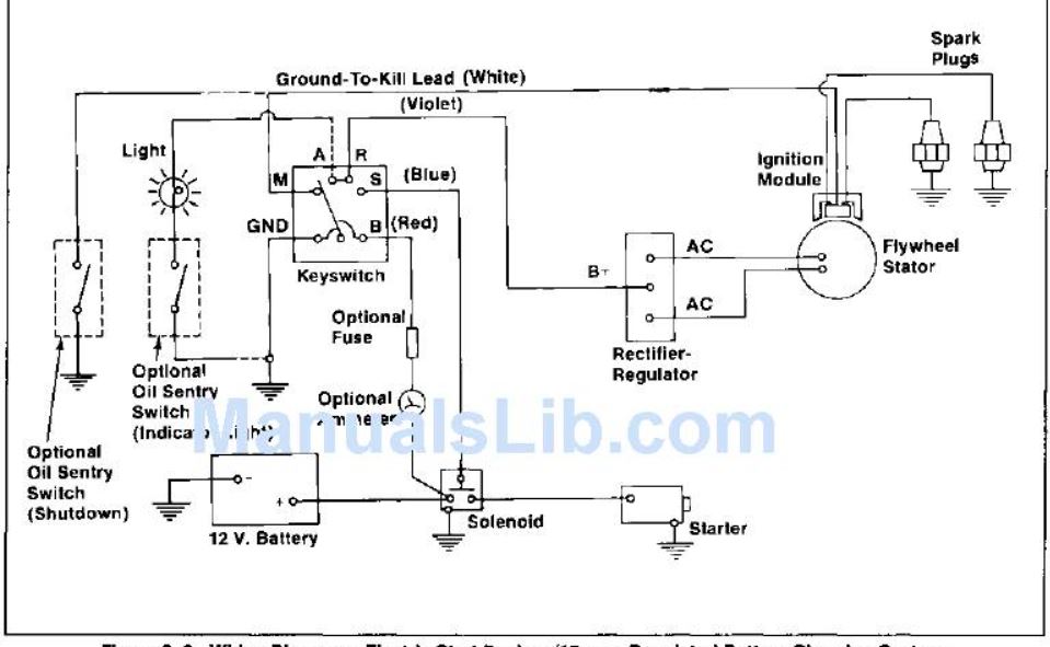

and this is the engine wiring diagram
so my question is would the output from the regulator be attached to pole 2 on the switch ? (ignition)
also its a ground to kill engine so i guess the only way other than a push button is to have a relay that when energised from the ignition holds a contact from touching earth until switched off. I think its the type with 5 terminals
does this sound right ?
I dont want to fry anything as this project started 15years ago !
