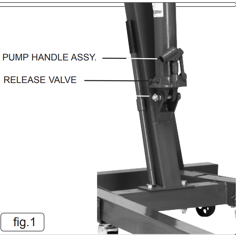

Problem is I have a loose bolt. Directly under the vertical post and ram. I see on the newer version below the bolts go straight through the box section with nuts underneath. On mine they are blind. I assume the nut was welded inside the box. No way to get at it. It just spins so you cant tighten it.
I assume even under a heavy load all the weight there will be pushed downwards and sideways? No upward force in other words?
Other solutions I could cut it off with a grinder - then drill straight through and put in a longer bolt with a nut underneath. Or run a weld between the baseplate and the box.
Or just leave it as it will not make any difference?
