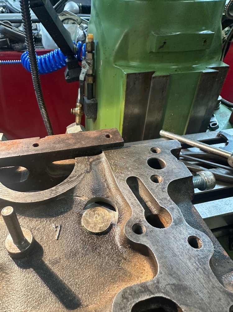

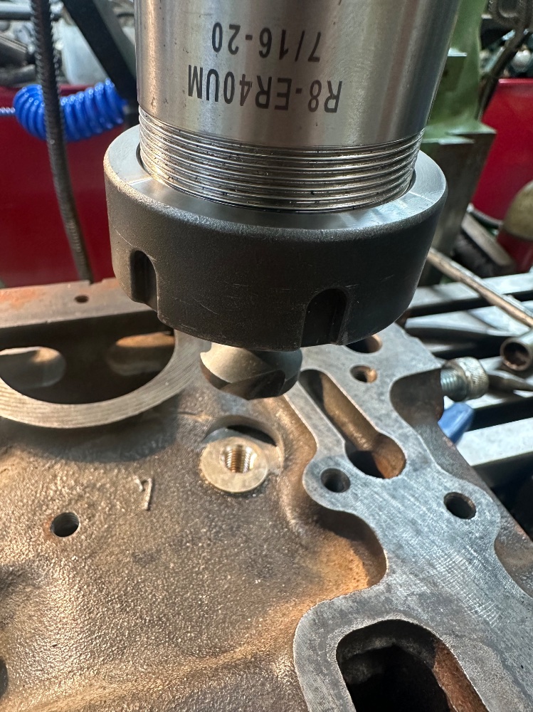

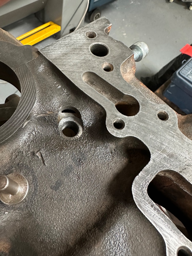

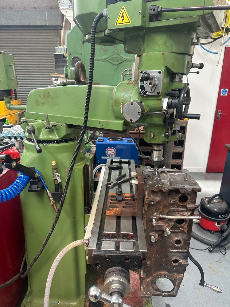

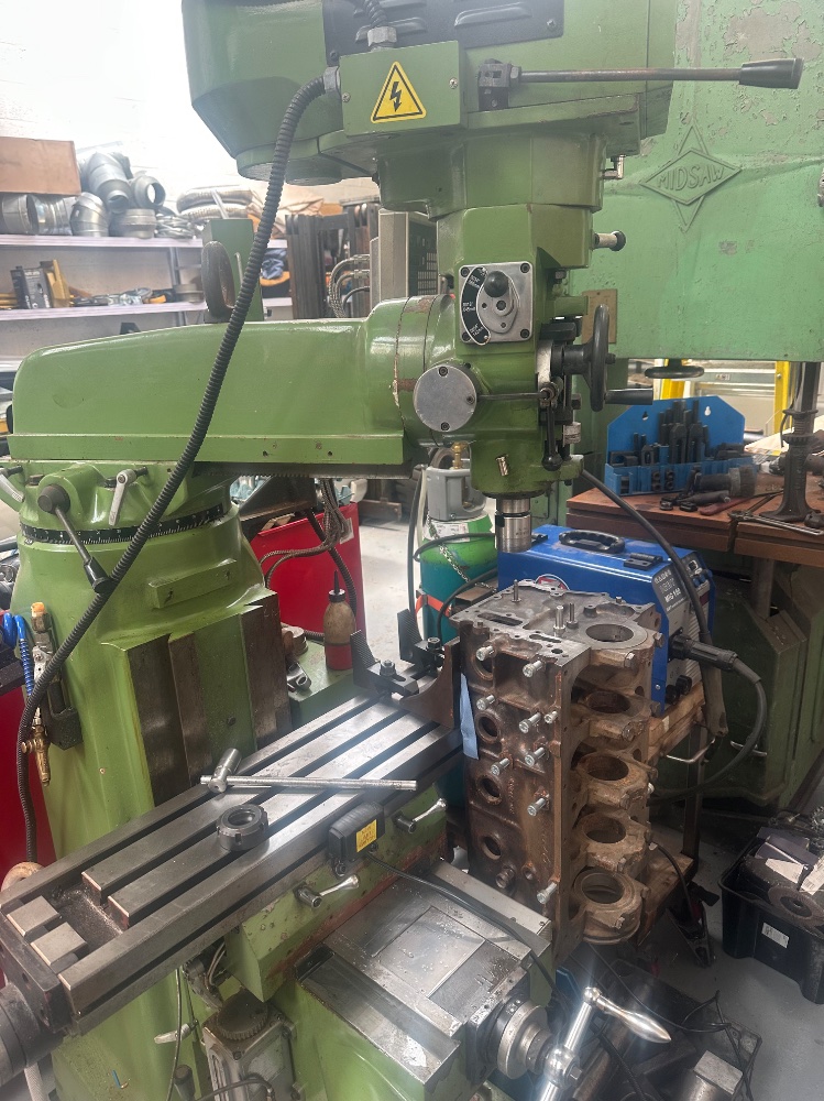

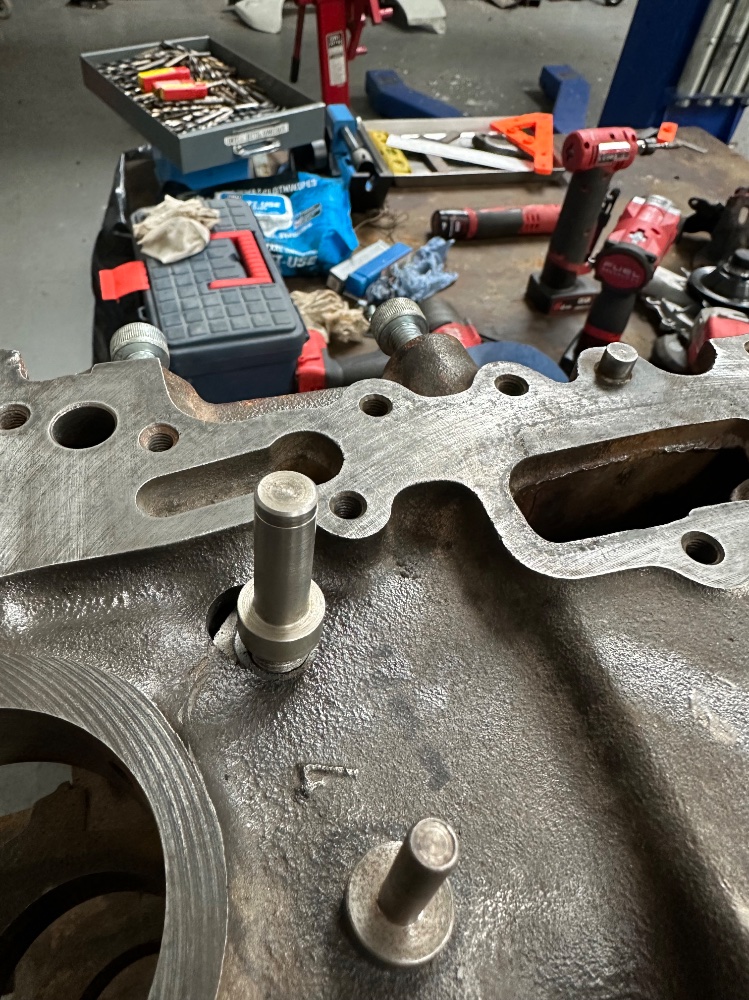

I’ve cocked up a drilling into an engine block I’m working on. It’s for a custom Opel 16v build I’m into.
Basically these are posts that hold the timing chain guide from a different engine. My jig wandered and consequently the hole and tapping is all off.
I also manage to break through into an oil way.

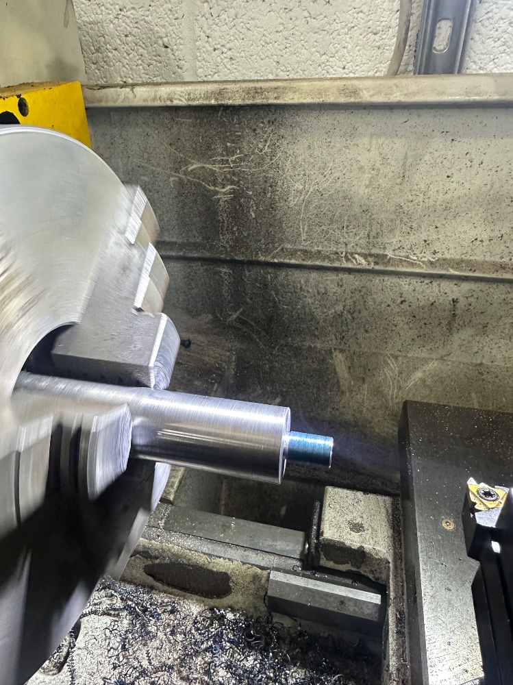

My thinking it to completly braze up the whole area also build it up to allow a platform for the post with plenty of thread, an m10 rather than m12x1.25 also to allow enough braze to keep it strong.
Do we think it’s possible to get enough braze down this hole now?
