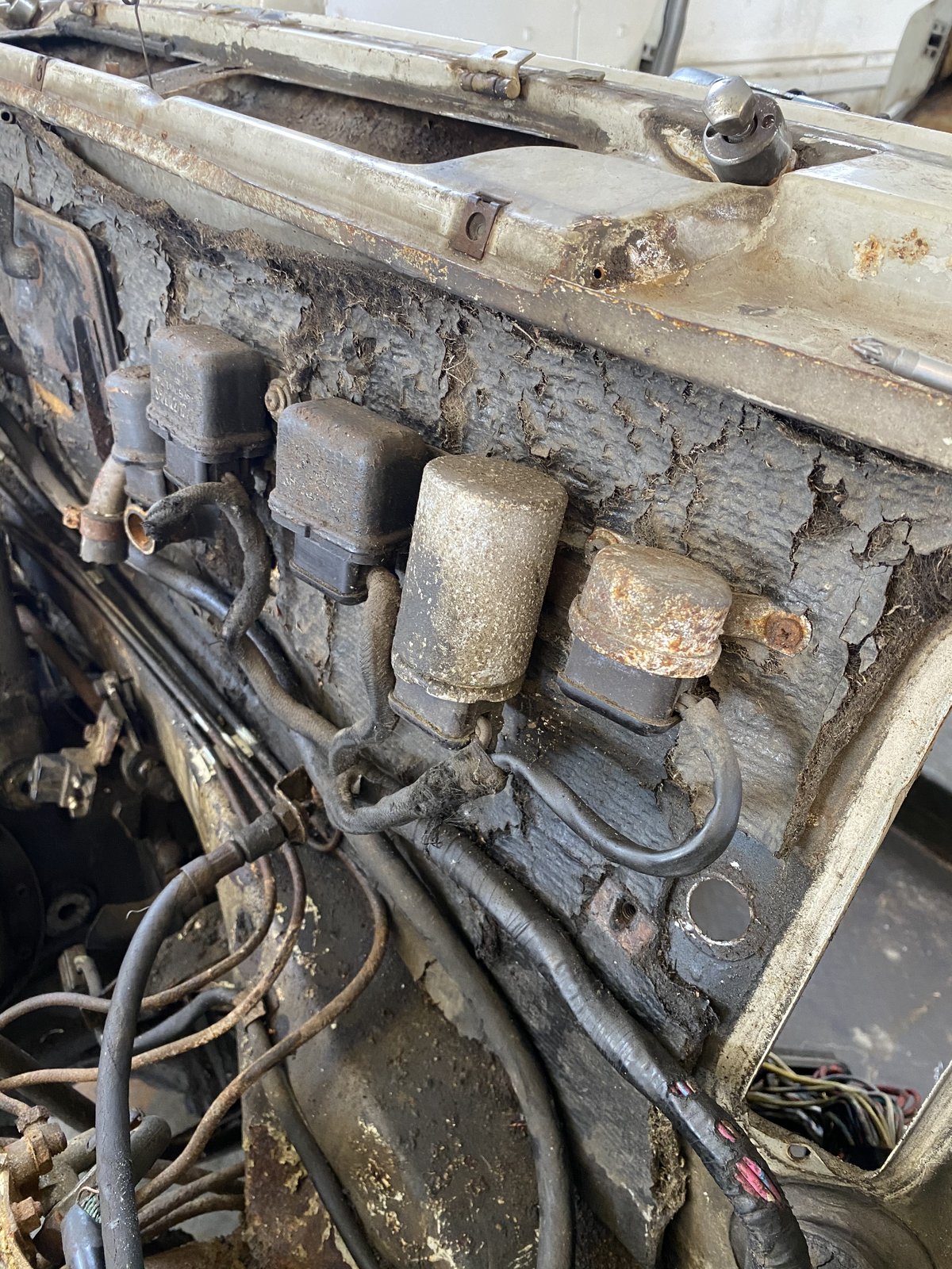

stuvy Member Messages 9,202 Jun 26, 2020 #1 I’m after a Mercedes Benz sound deadening material that goes on the bulkhead looks like this. any suggestions chaps? 3ABF4A36-7EA6-4715-B6B2-7C7AAD962084.jpeg 516.9 KB · Views: 94

H Hopefuldave Intergalactic pot-mender Messages 2,492 Location The Shed of Danger, surrey, England Jun 26, 2020 #2 If it looks like that, you don't want it, that's had it.... Dave H. (the other one)
D daedalusminos Member Messages 2,453 Location Norwich Jun 26, 2020 #3 Looks like it could be a backed jute felt or, if that surface is more like hard vinyl then hardura.
steveo3002 Member Messages 8,059 Jun 26, 2020 #4 http://www.automobiletrim.com/sound-proofing.html bottom of the page...jute

D daedalusminos Member Messages 2,453 Location Norwich Jun 26, 2020 #6 I don't think that's the bitumen type, looks more like the latex backing
M Melvyn Best Member Messages 2,063 Location Cambridge Jun 26, 2020 #7 Woolies will probably https://www.woolies-trim.co.uk/category/129/sound-damping
T tom2207 Member Messages 8,091 Location uk northern ireland Jun 26, 2020 #8 last stuff I installed had a lead layer in it too , worked well. But that was ten years ago .
stuvy Member Messages 9,202 Jun 26, 2020 #9 It’s very much like carpet that had originally a shiny finish it’s 1963 so must be period correct

Anguz Forum Supporter Messages 2,038 Location Northamptonshire Jun 26, 2020 #11 speak to woolies.. if its still available they will have it
stuvy Member Messages 9,202 Jun 26, 2020 #13 Anguz said: speak to woolies.. if its still available they will have it Click to expand... will call them Monday daedalusminos said: Sounds like hardura then.. View attachment 238202 Click to expand... it does but the stuff looks black. On the other two cars we have it’s the same
