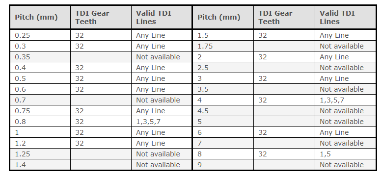

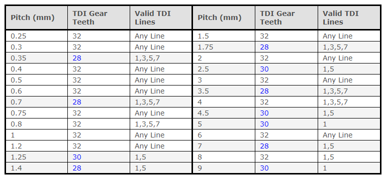

I've got a thread dial indicator calculator on my website and someone just contacted me asking me if I could help them with suggesting the appropriate number of gear teeth and what to put on the dial for a home-made thread dial indicator.
I've done this before by playing with the "Custom" setting of my calculator, but it occurred to me someone on here might have the genuine article and could tell me what it looks like so I can answer his question more accurately!
